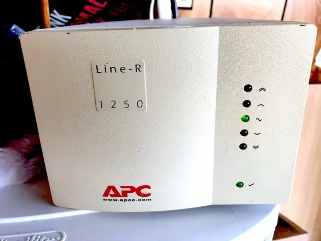

Since I charge overnight using the OEM L1 charger, I plug it into an automatic line voltage regulator (AVR).
The unit protects against: brownouts by boosting voltage, overvoltage clamp down, noise, spikes, etc...
This item or a battery backed up UPS are great ways to protect your equipment.
I'm an IT person so naturally all my computers at home and work are all protected on either line conditioners, AVR, UPS....
Here's what I use for my L1 Honda charger:

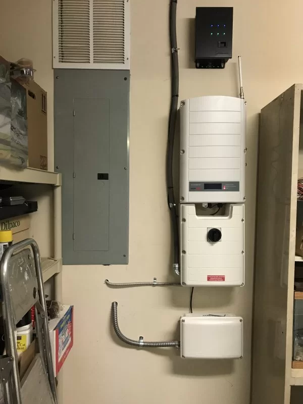

I chose an Intermatic Smart Guard whole house surge protector that for a little more money comes with 3 replaceable modules. That way if it dies gloriously in the line of duty, I don’t have to buy a new one and pay an expensive electrician’s bill to install it. All I have to do is replace the plug and play module ($40). I got an open box on Amazon for $200 and paid my electrician $75 to install as a surface mount (it comes ready to flush mount if you want). That’s cheap insurance for the combined prices of electronics, Solar PV, EVSE, and new PHEV.
It’s the black box above the white inverter.
Thanks for explaining your set-up. Sadly, I use a L2 EVSE to charge my Clarity, and I was not able to find an affordable "whole house" AVR. Most of the AVR's out there seem to fall into the individual device (such as a desktop computer) category and are affordable OR they cost as much or much more than my Clarity but protect high cost machines such as an MRI where the cost:benefit ratio still works well. So (see below) I ended up with whole house surge protection to help prevent voltage spikes but offer zero protection for under-voltage situations (brown-outs). Fortunately, the utility suppliers in my state don't seem to have many if any of those situations, but I still have a stand-by portable generator to help out if necessary. If you know of some affordable whole house AVR, please send me a private message and, in any case, thanks again!
