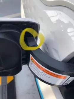

Didn't someone post a picture of the arm of the charger door getting Dremeled down? It was some plastic bump that needed sanding off. That supposedly fixed the sticky door issue.
There is a raised area where the door hinge connects to the door that is there to make the hinge fit tighter in the slot it emerges from, when the door is closed, probably to make the door centered vertically in its “frame”. There is another similar raised area on the bottom side of the hinge. I sanded down both until the door swings freely - havent applied any lubricant. Door opens fine now.BE7F288A-607D-4946-AD80-C304446CC4D7.webp
