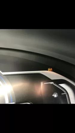

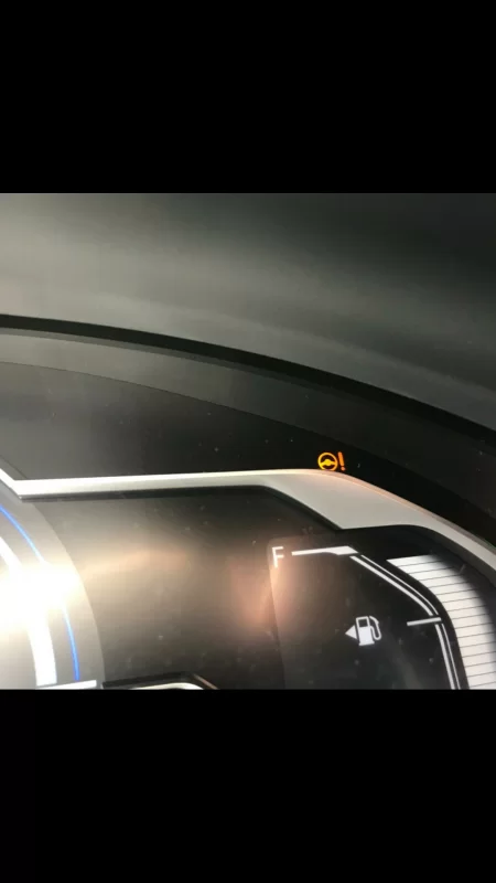

Steering Wheel with Exclamation Warning light
Richard Hwang
Car cannot move. What does this error meant?
Can you show us the rest of your display in front of the steering wheel? Could be a number of things. Is your door slightly ajar?
Electric Power Steering (EPS) System Indicator
● Comes on when you set the power mode to ON, and goes off when the power system is on.
● Comes on if there is a problem with the EPS system.
● Stays on constantly or does not come on at all - Have your vehicle checked by an authorized
Honda Clarity Plug-In Hybrid dealer.
2 If the Electric Power Steering (EPS) System Indicator Comes On P. 549
The error went away after many restarts.
