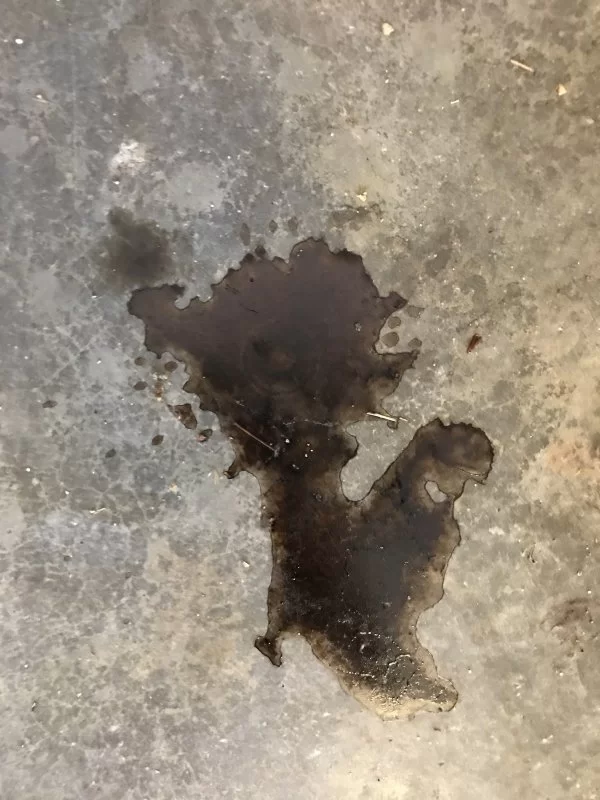

I recently noticed oily, almost tar like stains on my garage floor. They seem to align with the passenger side of the car near the motor or front wheel. Calling the dealer today but was curious if anyone else has had this happen to them?

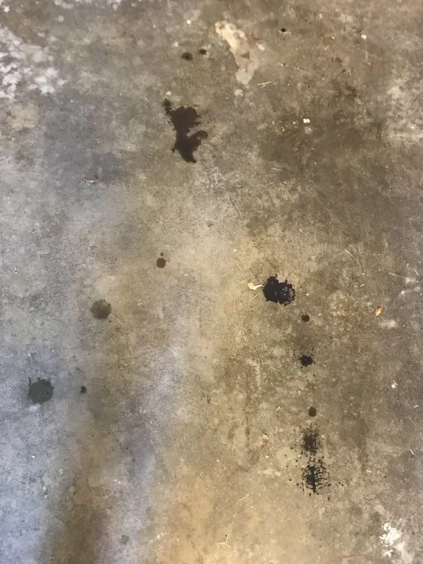

This crossed my mind too. I took a photo of the stains but was unable to upload here, my computer doesn’t trust this site but my iPad is just fine with it. Basically it’s a larger stain by the wheel and a trail of spots as it moves out of the driveway.

Here is the garage floor

Yes, it was mostly dried up by then. Didn’t feel like water but did not detect a strong odor.
Please let us know what dealer finds. I have same thing and got the “maybe it’s the AC drain” , but it lasts through rainstorms (at my work parking spot) so seems unlikely.
It looks like dirty water. Have you felt/smelled it?

I picked up the car today from the service center. They agree with you, just some dirty water. We had some very heavy rainfall around the time this happened, they think it just washed out some grimly undersides.
