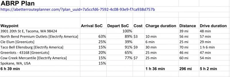

You do seem to have plenty of charging options along the route to Tacoma too so definitely possible to drive it back. Plugshare and ABRP (a better route planner) are good resources:
https://abetterrouteplanner.com?plan_uuid=7a5ccfd6-7592-4c08-93e9-f7ca938d757b
I'd probably charger more at that first stop at GreenLots, at least until the charge rate started to taper around 85%

ABRP is a very useful tool but don't expect one button route planning like Google maps. It's still missing some charging options and often does dumb things when routes get tricky (near maximum range) and has to be manually forced to go where you want.
Last summer I was able to get from the North Bend EA chargers to the Ellensburg EA chargers using only about 64% of the battery. I think I had a tailwind because I used more battery going back downhill on the return trip. I wanted to skip the Cle Elum charger because it apparently only charges at 20kW but still charges by the minute. I think the safest/fastest thing to do is use ABRP to figure out what minimum battery level you want to be at when you get to Cle Elum, and if you're below that level when you get close, stop to charge there, but if you're doing well then keep going to Ellensburg.
I think ABRP uses the MINIs published range and efficiency when in reality that is very easy to exceed. I think it also overestimates the charging time a bit too.
Using it to find a minimum acceptable battery level at a landmark is exactly what I did on my return trip from the dealership. I ended up passing my emergency L2 with double the expect range left.
