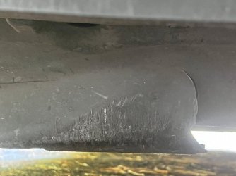

So the Clarity, as we know, has an unreasonable low "splash guard" if that's what it's called in the front, under the car. What I mean is that parking in a normal space with one of those curb-cut things infront, causes the car to scrape if the bumper goes over it. I don't mean driving over the curb-cut, just the front bumper coming forward enough so maybe the front wheels touch it.
Anyway, when mine was new, I had the bad fortune of parking over one with rebar that caught on my splash guard, causing the front part of it to split. See attached pic. Also I don't think it was initially flopping down at all (as it does now). I think it got bent, then repeated "touches" or scrapes when parking over a normal height curb.
Sadly, it looks like the part is $350 or more, and doesn't look simple to me to replace (I have no lift) and not really able to get under my car.

- Does someone have a repair idea that isn't $500+ dollars? I am open to ideas like somehow sowing the two pieces back together if that makes sense.
- Is there any chance the dealer would consider this a extended warranty/hondacare item, given how low the car is. (I'm guessing no chance).
Also I don't know if the splash guard if that's the correct term is essential or more or less cosmetic. I mean now that mine is ripped, is the risk some type of debris gets into the engine or some such. I guess help understanding the risk of leaving it as-is if that's what we do would be helpful.

Is it the undercover?
https://honda.oempartsonline.com/oem-parts/honda-under-cover-74511trva00
Now that you can get under the car, I would first see if I could pop the break back into alignment and if I can then glue it with gorilla glue or other flexible glue. If not then I'd make a strip of another plastic or stainless, drill 2 holes on each side, and screw it back together across the break.
