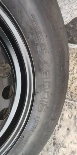

Yes, I bought and swapped out the gunk, compressor and tray for a 'spacesaver' wheel and it fits well.
Don't forget the nuts (if different for a steel wheel), spanner(s), jack, gloves and a bag for the dirty punctured wheel.
Is there a reason on the Niro I can't use the lug nuts from the wheel I am removing to swap for the spare?
On my UK Prius the 'lug nuts' for the alloy wheels were totally different (long, flatended, washered tubes) to those required for steel wheels (chamfered short nuts). On the E-Niro they appear to be the same for both in the UK.
I have no idea what is required for the US fitted wheels so it would be wise to check before your puncture and find you have a spare but can't fit it!
P.S. In the Prius I never needed the spare wheel in eight years of ownership, just a couple of very slow leaks. I work on the principal that it never rains if you carry an umbrella.
P.P.S. I only paid £20 for an unused spacesaver doughnut, jack etc. in a scrapyard.
