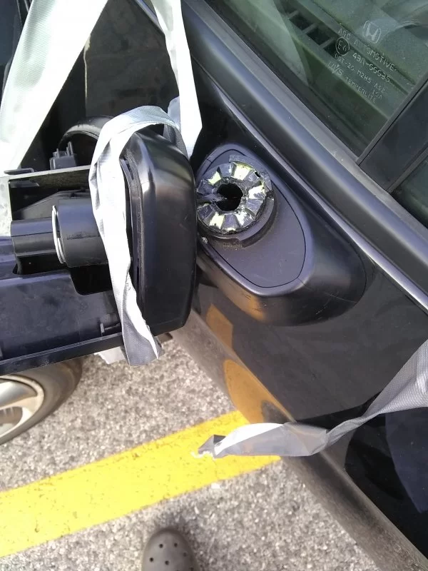

Someone decided to sideswipe my driver car mirror and knocked it off the swivel/spindel. It appears to be the hinge where the motor can swivel into itself
(Yes it was a hit and run and I have no idea whom it is)
The Mirror glass was not damaged and all the electronics are working properly. (Right now it is attached by the wire that controls the position of the mirror)
So far no junkyard has it ( I guess it's to New of a car)
I looked at Honda parts and it appears they sell the assembly as one unit..
I'm curious to know if I the can obtain the plastic component alone,

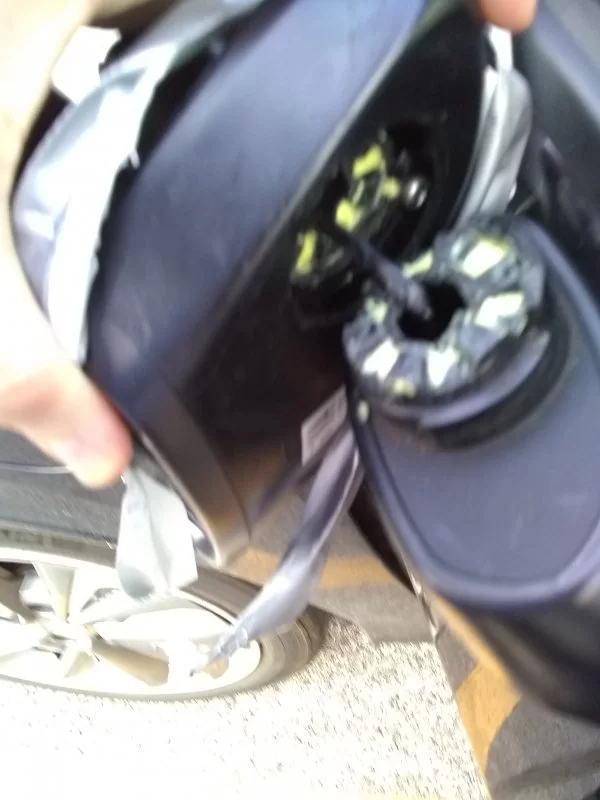

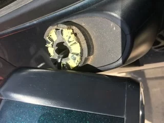

I have included 2 images of the break of the mirror..
Question is can I get away with just replacing the spindle using part "76255-trv-a01"
Or do I need to replace the entire mirror using part 76258-trv-a01
Again I have to ask how mechanically inclined are you, and is this project worth 8+ hours of floundering around cutting and splicing wires and figuring out how to restrain tension springs and whatever, just to save a few hundred bucks? Did you read the other thread thru of the other member who reconstructed his mirror and the challenges he ran into?
Me? I’m actually an auto mechanic. And if this were my mirror I would simply buy a new one and bolt it on and plug it in within an hour. They don’t cost all that much and I have no interest in that kind of mirror reconstruction project.
Body shops don’t rebuild mirrors either, they just replace them. There is a reason...rebuilding them is a time consuming and tedious hassle that doesn’t pay.
But every individual is different. Only you can decide for yourself if the hassle will be worth the cash savings. If you decide to rebuild it you will want to remove it from the car and disassemble on a bench first. That’s the only way to confidently ID exactly what parts you need to order. We can’t tell from photos and only one other human here has had his mirror apart before. You’re not using the mirror anyway if it’s just dangling there, so remove and assess...
