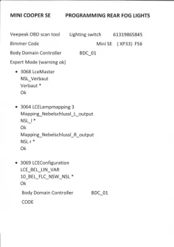

Just had my SE software updated and everything was put back to factory settings, I have used Bimmer code to change a few things however activating the rear fog lights for US spec cars means using expert mode to program.
I have the procedure written down, but one line of code has changed in the new software update anyone have any experience with the rear fog light setting (new software) cheers.
