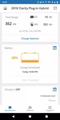

Below are 2 pics from yesterday after a routine drive using EV nothing special or planned. I checked the SoC gauge on the dash against the Hondalink SoC. The Clarity once again displays a tight correlation to the 5% per bar at the lower range. It appears the 5% per bar is more loosely correlated at the top of the scale.
Again...more info off one Clarity. Pic/screenshot taken 10 seconds apart. IMG_20190202_144217.webp Screenshot_20190202-144133.webp
An interesting responsible be what HV charge mode looks like when driving. Seems almost like the issue are going into an HV charge type of condition.

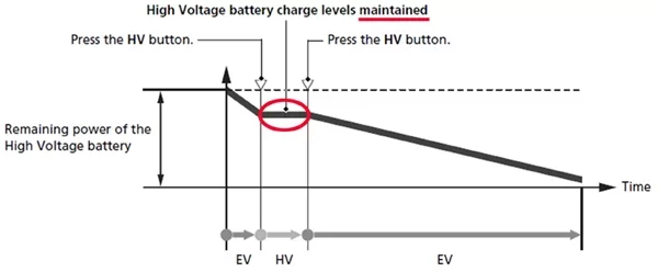

I have a question. Is it written anywhere that the car should not drop EV range when in HV mode? I don't think that is necessarily abnormal. To me, HV mode is made to drive like a Hybrid vehicle. When you are driving a hybrid, the state of the battery charge will vary depending on driving conditions. I have seen at times when driving in HV mode that my EV miles may go down by about 5 miles during a drive, but usually it remains fairly steady.
It is written:
Owners Manual, page 16
To enable HV, press the HV button. In HV, the engine may run at
times to drive the generator so that battery charge levels can be
maintained.
I added the red underline and ellipse to emphasize what is written. Clearly, Honda could run the engine as much as needed to implement the charge-maintaining HV Mode described on page 16, but most drivers (me included) see the SoC decline when driving with HV Mode engaged. Why, Honda, why?
I apologize for continuing to use the term "HV Mode" when the manuals say only "HV." HV and HV CHARGE are definitely modes, but the manuals reserve "mode" for ECON Mode, NORMAL Mode, and SPORT Mode.
