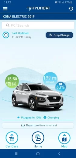

2. If I charge at 120V, can you still remotely turn on the pre-warm climate control in the car and not use any of the battery? Or is the 120V supply simply not enough for that? Would it still allow you to do that though?

Another thing to keep in mind when charging from 120V and preconditioning, is that although the A/C usually uses < 1KW, US models don't use that for heat -- they have a resistive heater. I've definitely seen this pull more than 1KW when it starts up, so that could exceed your charging rate.

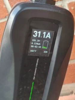

Here's my EVSE currently running on a 3 phase outlet. Showing 191V, the car is showing its receiving 6.0 kW. At home the same unit is usually between 240-248V and shows 7.6 kW.
Interesting that you can still charge at that low voltage. I thought the spec was 230V + or - 10%.
There is some confusion about the voltage range for this Morec charger. Saw elsewhere that the spec says 110-240, but doesn't say that on mine. Sure would like to use this on a 30A 120V RV outlet (with an adapter) if possible. Apparently this can be done with some other chargers.

The back of mine shows Input/Output: 230VAC 50Hz but it's working fine. Not sure if it would work on 120V. Interestingly, the EVSE that came with my Kona shows 120-250V I believe. Might be to 240V, I only opened the bag, tried it for 5 minutes, then put it away, hopefully for a long long time.
