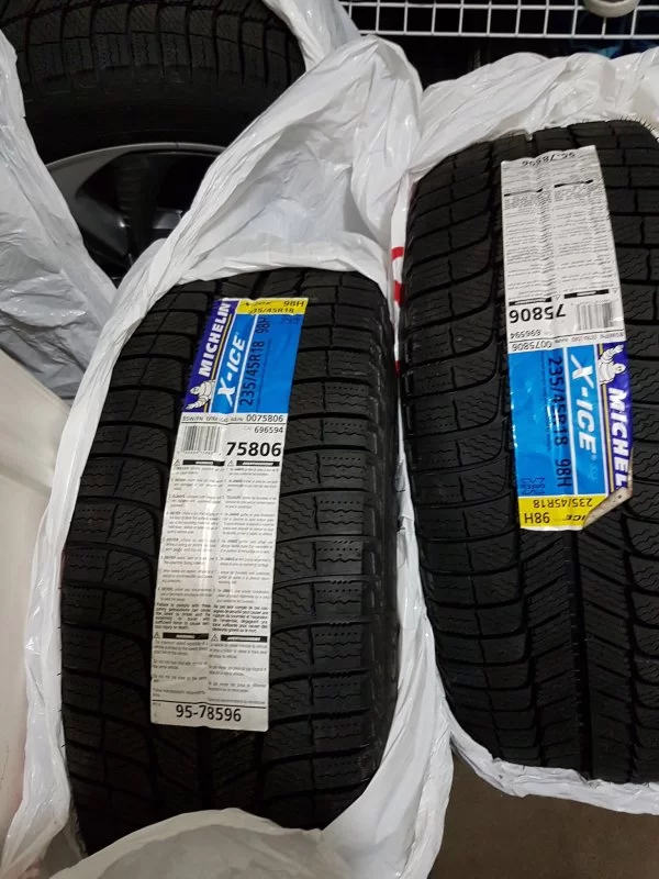

I just mounted Michelin X-Ice winter tires on my PHEV Touring in the OEM size. I've had experience with that tire on other cars and know it is outstanding in winter conditions. On the 10 mile drive home on varied roads, the X-Ice and handled and rode nicely, didn't slap rough pavement as hard as the OEM Energy Saver, but were slightly louder with a low-speed hum. Not objectionable at all, but noticeable at low speeds.

Swapped over with oem sized tires on stock wheels.

I just used the OEM rims. I do wonder if snow/ice will build up in the plastic decorations on the wheels. If it does, I can just remove the plastic for the winter. Costco only charges $40 for a winter/summer changeover. The place I bought the tires will do it for free twice a year, but they don't take appointments and I've had some loooong waits there for mounting/balancing. I would have bought rims in the 18" size for the winter tires, but my wife and I couldn't agree on which ones :rolleyes:
