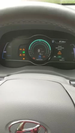

Was just driving my car and the car lurched and stopped accelerating, "Cruise Control Conditions No Met" message came on and then every warning light lit up. The motor powered down and the car basically stopped in a live lane. Gravity kept it creeping forward until I could get off the road. Turned off and on. Didn't fix anything. Disconnected battery and reconnected. Seemed to fix things. Started, drove stopped, started again. No issues. Drove 3km and then it all happened again. Dash fireworks, no power. Pulled over. Redid the whole 12 volt riggamarole, started up fine, drove 2 km back, it happened again as I was making a left turn across live traffic lanes. By this time I was thoroughly frustrated and tromped on the accelerator, the car lurched and jumped, loosing all motor power then accelerating. I managed to get into my driveway a kilometre away. Waiting now for the tow truck to take it to my dealer 45km away. They can't even look at it until next week! Well, I had a couple of hundred kilometres of quiet driving with my nice new drive train before it became crippled again. I guess I shouldn't have been so upbeat. :(
Sounds like the 12 volt might be the common denominator, maybe a new one would make the difference? Good luck, keep us posted.
Hopefully a connector was not locked in place during repairs and came loose or coolant clamp on a hose , possible 12V failure as well...who knows.
Any sign of fluid leaked out, reservoir level OK?, or measured the 12V residual voltage level at the battery terminals?
It definitely sounds like an issue that started during the repair process, seeing as it never occurred previous.
I did let my home dealership know that the car was just ripped apart and rebuilt last week so they could consider if something perhaps wasn't reconnected as well as it should have been. I'm really hoping the car threw a code that can point them in the right direction. I was a bit dismayed that Blue link health status reported as "All Systems Normal" while my dash was lit up. :(
This happens to my Kona (2021 Ultimate) whenever I go longish periods without using the brakes, regardless of weather conditions. Tapping the brakes works for me every time. It's annoying to have to do that, though, especially on the highway, so I try to think to use the brakes for slowdown before I enter the highway.
Yep .. this is how mine behaves as well. Doesn't happen that often, fortunately.
Turns out the dashboard light show and erratic power situation were caused by a faulty accelerator pedal assembly. It's on backorder (of course) and I'm now being offered a rental car for the duration. I hate gas cars, period, but having to pay for gas these days is an additional annoyance.
Potentially a dangerous situation if the accelerator pedal variable resistance sensor is defective, matches with your original description.
Hopefully the part is small enough that replacement can be sent by air, reducing the inconvenience (and cost) of an ICE loaner.
The list of unique defects continues, yours was the first (and possibly the only posted) EPCU replacement, now add to that a accelerator pedal assembly (again after the car was in for service), I hope your luck turns around after this one;)
You'd think at some point I would have uncovered all of the obscure, faulty bits, wouldn't you?
