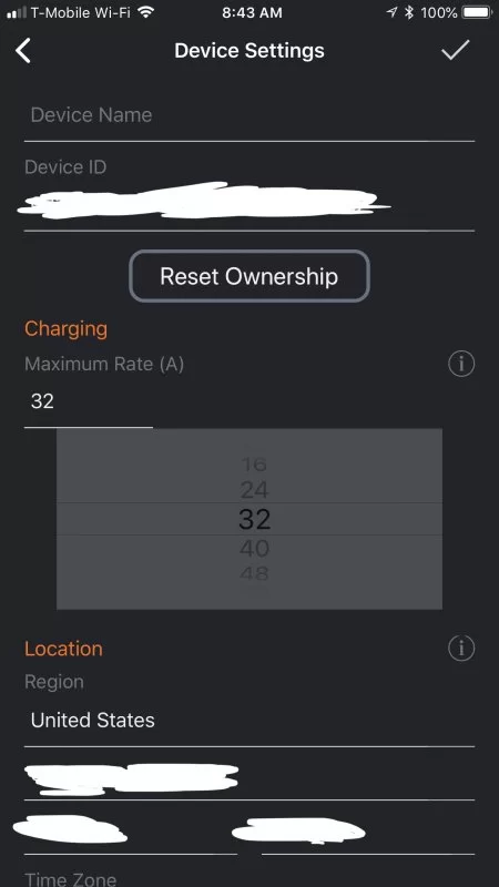

My Juice Box has this setting right in its app. It allows you to set the maximum charge rate based on your circuit size. And best of all it doesn’t void your warranty. I attached a screen shot.
