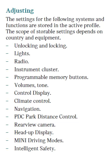

Is Rob's the only MINI that has a memory for the position of the side mirrors? My 2021 Iconic SE doesn't have that. Here's what the Owners Manual says:
I have a Signature Plus, and the mirrors adjust depending on the Driver Profile. But, I had to select the profile every time I got in the car, and it bugged me that it wouldn't just remember the key that I had linked to each profile. After reading this thread, I went and got rid of the message at startup and now it doesn't come up. I drove once after my wife and it reset to my settings (the mirrors too), but I haven't yet gotten to see if it will change settings again with my wife's key. I hope it does. Anyway, the mirrors should work.
