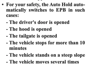

No, and note there are consequential conditions around using it. Just try backing up in Auto Hold with the driver's door ajar.

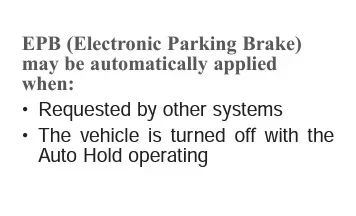

As I read it, the EPB is applied automatically in certain circumstances only if the car has been brought to a stop with the paddle, and always when the car is turned off with Auto Hold engaged.
The first item is what I'm referring to:
Thanks for pointing that out. The info about EPB is scattered and I didn't look far enough.
This is from the US manual under One Pedal Driving:
And then later under Electronic Parking brake:
