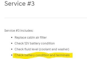

Hello
Service #3 has
Does anyone know what is done? Can owner do it themselves?
thanks.
Ed

Hi yes they are only talking about the 12 volt battery, NOT the traction battery.
sorry to disagree. there are 2 entries for check battery. One is for the 12 volt battery and is in every service list (1, 2, 3). Service 3 has a separate entry for, what I presume is the main EV traction battery.

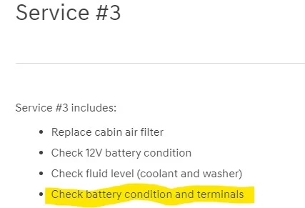

Hello
Service #3 has
thanks.
EdView attachment 18627
Could be as simple as a software (BMS) check, as well as physical inspection of the connectors to the HV pack front end- only visualized with the bottom covers
off. The second part you could do yourself, while the first part would be done using a diagnostic tool only the dealers would have access to.
I don't recall seeing this as part of the regular maintenance, at least in my 21 manual, but it can't hurt to have it done.

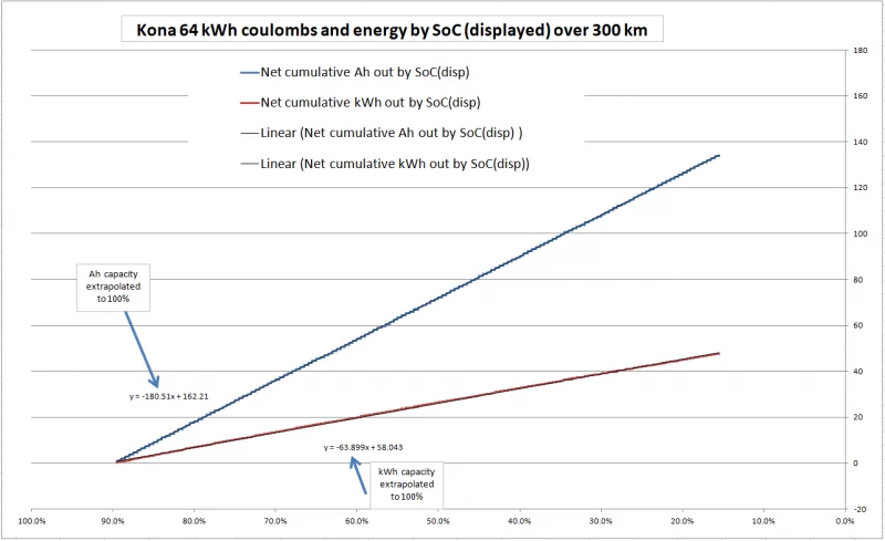

The BMS contains a "precision shunt" which measures current in real time, both in and out separately. Along with the related pack voltage measurement, that data integrated over time counts cumulative coulombs and cumulative energy and places the values in the four registers readable over OBD.
Battery capacity can be closely estimated by logging and plotting the data, then adding a linear trendline to extrapolate that over the full 0% to 100% displayed SoC and to determine the rate of change (the slope).
You would drain the battery by driving and the wider the range you can span the more accurate the results will be. If you could actually manage 0-100% you could change the word estimated above to measured. It matters little how you drive because you're only doing that as a convenient way to drain off the energy.
I took this data December 2021 and as I expected obtained the advertised capacity of 180 Ah and 64 kWh to within 1%. The thin black linear trendlines follow the data so closely you can barely see them in the graph below.
