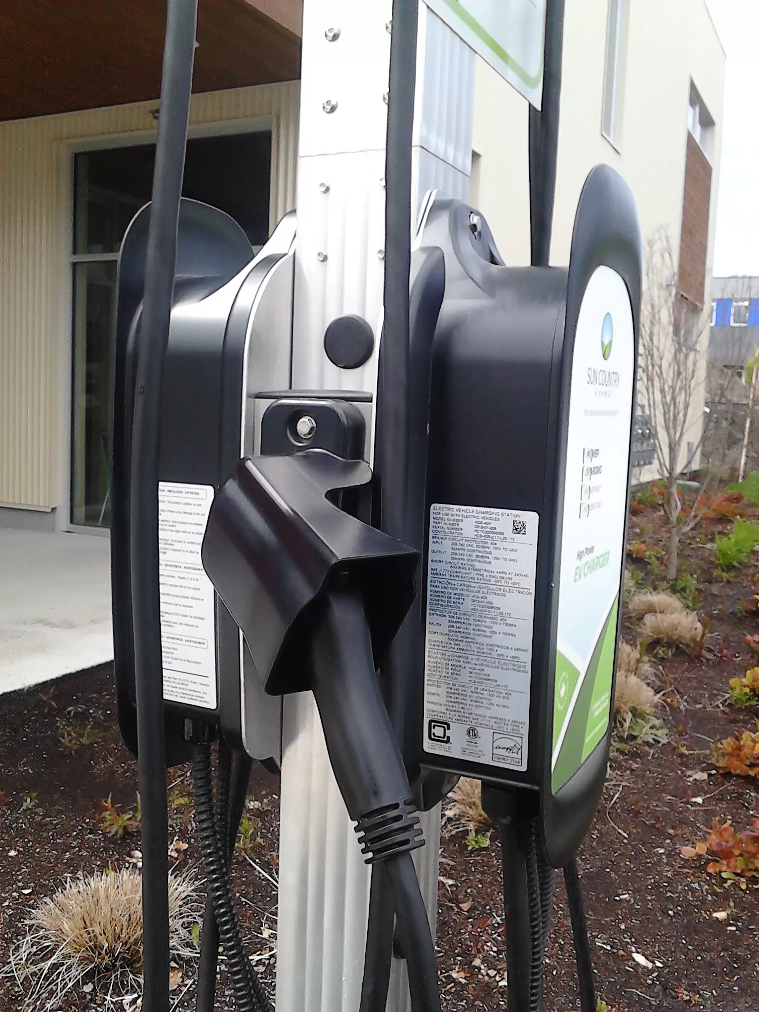

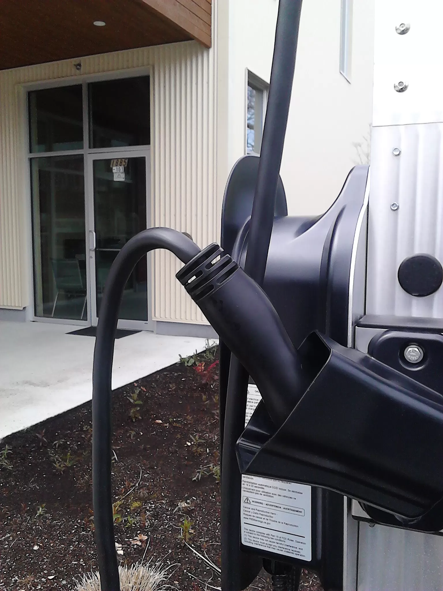

Ran into this little jewel, another free public EVSE close to my house.
The electrical installation contractor obviously had little experience with cord management.
As you can see , the cord management holders are pointing to the stars:
causing the J1772 handles and tethered cords to do the same:

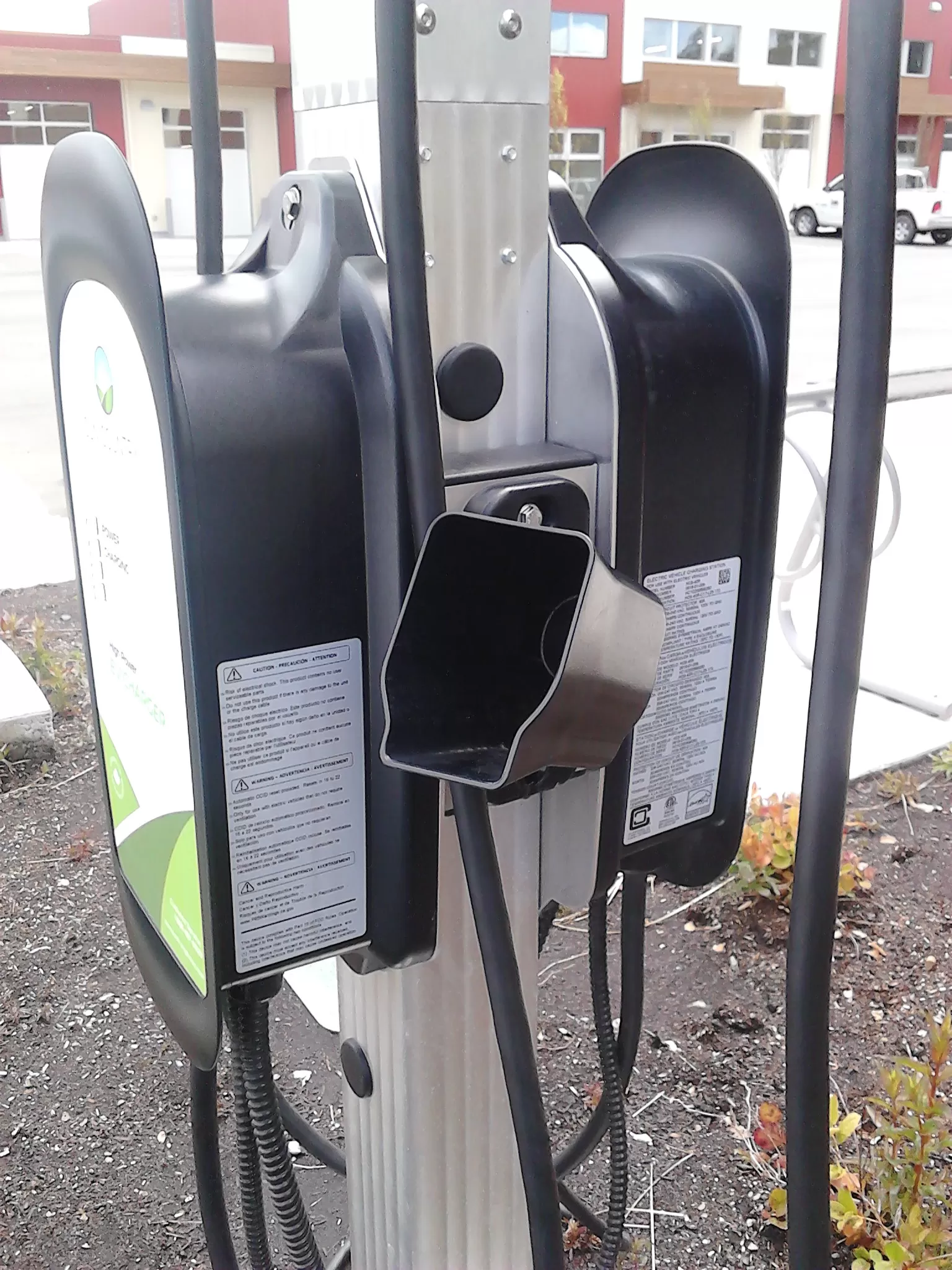

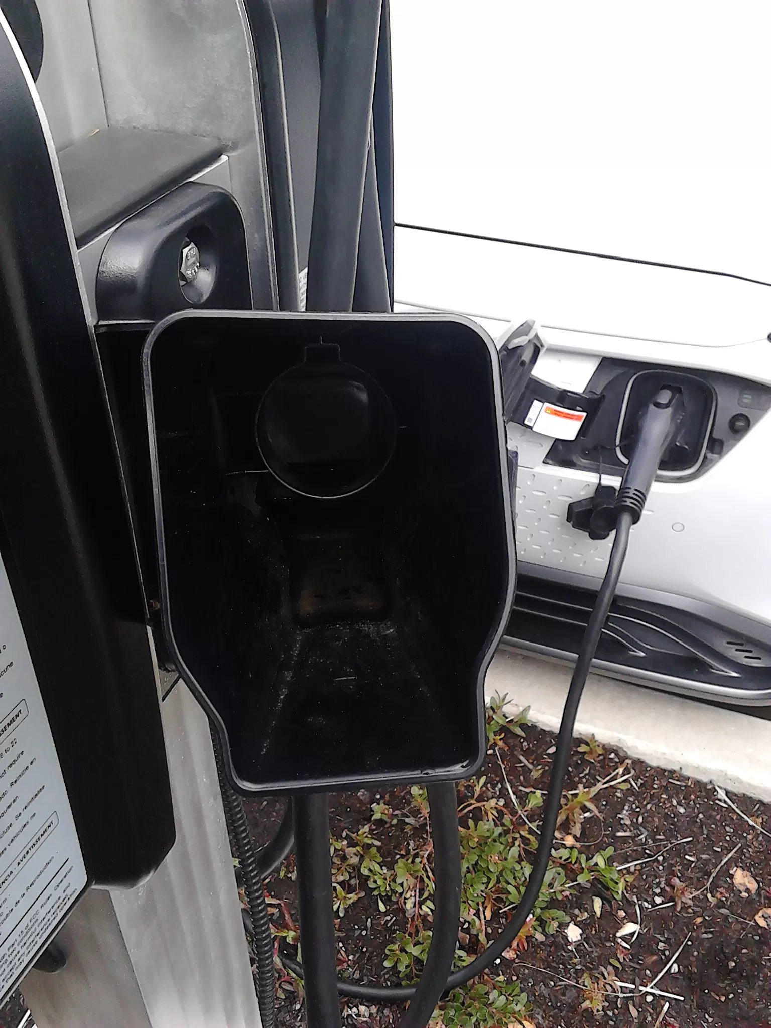

here is a picture of the water gathering in the "cup" - giving the connectors a "good rinse" before plugging in:

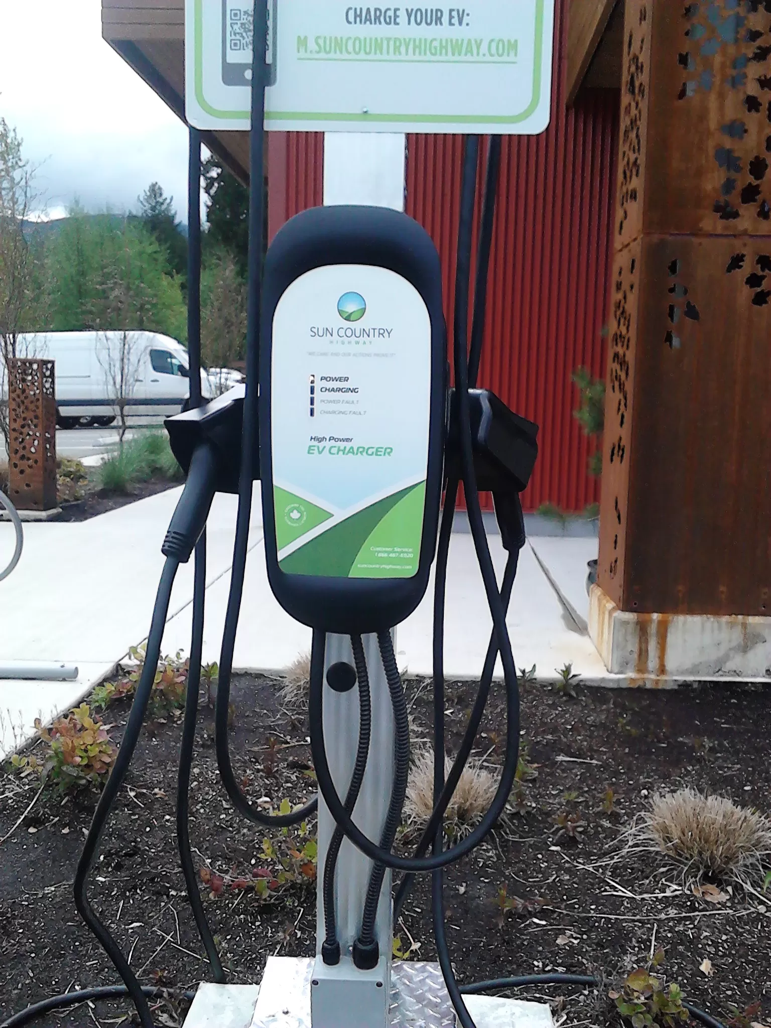

So I dug out my 1/2" socket from the back and did this to both management guides:
Now it looks a little more "professional" and indeed more functional:
It took literally a few minutes, car had 1 km range added by the time I was done:)
Yikes. Not only is it demonstrably incorrect (if you were to give it even a moment's thought) but, jeez guys, you're clearly new at this whole EV thing. Read the installation manual!
Not exactly a dry type environment here. All electrical contractors (at least those who install EVSEs) should be required to actually use this equipment on their own vehicles (in pouring rain) to give a better understanding of the circumstances.
The handle connectors were actually submerged in water, and trying to push that release pin (upside down) to get the handle out was a real contortion challenge for me (bad fingers) as well...not anymore;)
