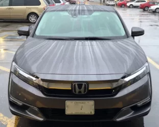

After hearing about semi-permanently protecting the exterior surfaces with a 'nano ceramic' coating from our dealer and a car enthusiast friend, I was intrigued and researched this quite a bit. Last weekend, I went ahead and coated the paint, wheels, trim, chrome & lenses on our 2 Clarities with CQuartz UK 3.0, SiO2 quartz coating. It took about a full day or so per car of labour but we are thrilled with the results and thought I'd share what it is like in case others would like to do similar while your cars are still relatively new. Outsourcing this job was too expensive for us so it was DIY. I figured this is worth it to make washes easier, minimize repeat polishing / waxing and maximize the cars' shiny new appearance. The dirt & dust mostly just rinses away.

Today, the coated car saw its first rain. It beads up and rolls away like this under very light rain. Cool pattern and mezmerizing to see various beads spontaneously roll off! I've never seen anything like this before.
