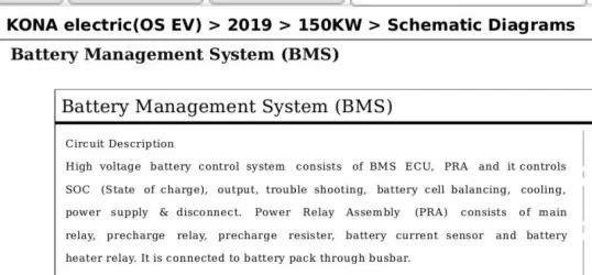

In the Kona service info there is a hint that some kind of balancing *is* done...
but there's no further detail about methodology. Do I have to sit at 100% for several hours, or not? How
much power would the balancing circuitry need to dissipate? Where might the tech community be able
to find such answers, not just for Hyundai but any other manufacturer / model too?

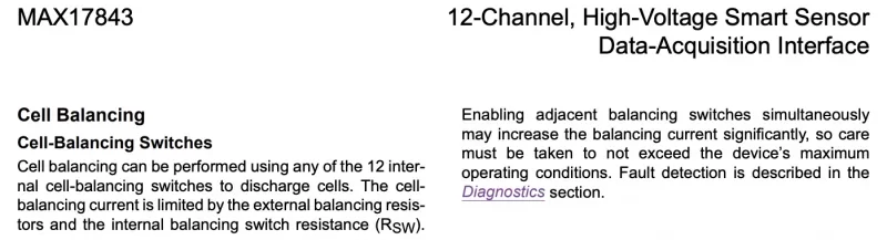

From there I found a Hungarian DIYer's site: https://varsanyipeter.hu/ which has a colourful description of the Kona pack internals. I translated it into English paragraph by paragraph using Google Translate and no additional editing, PDF attached. I'll let you draw your own conclusions, but from what I can see (as we speak) that points to the MAX17845 to handle balancing, but the closest datasheet I could find quickly is for the MAX17843, which is also mentioned.
Pages 40, 41 of the datasheet points to resistive discharge balancing.
