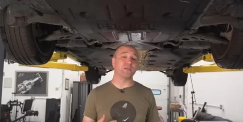

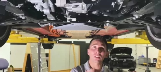

It will be fine as there are underbody panels per Savagegeese. However, if you follow Munro Live, viewers are very unhappy with the exposed HV wires because (didn't disclose they removed the underbody panels).

No worries on undercarriage spray, but I always skip it because it's pretty unnecessary for the SE. Not a lot of nooks and crannies underneath. My winter wash routine is always basic wash to get the road salt and grime off, but skip all the add-ons. And I really avoid the wheel scrubbing.

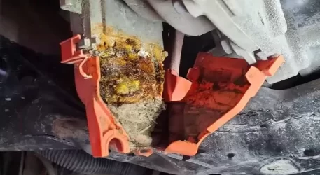

So, are there any exposed high voltage wires that might be subject to corrosion, as seems to be the case with the RAV4? (An $8k repair.)

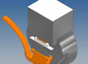

Technically yes the HV wires are slightly exposed, but it's shingled with the skid plate. RAV4 Prime (and hybrid) cablegate occurs because there is water ingress through the connector. See RAV4 prime corrosion picture below.

Interesting! I did not realize that Munro removed panels prior to filming. Always thought that was so strange they were exposed like that. Since mine (2022) wasn't like that I assumed Mini made a change somewhere along the way...

I'm still unhappy that Munro, who likes to talk about how BMW leaned on him to help create their new MINI, couldn't be bothered to even take the SE around the block in that report. He was too busy supervising the remodeling of his home and left the review to his minions and they did a very haphazard job--like not making it clear they'd stripped off the battery-protection panel.
