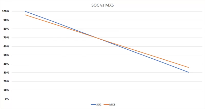

The first PIDs I would like to examine are SOC. There is the SOC that we all know from the app and then there is another one behind the scenes which is called
HV Battery Cell Max State of Charge (%) (MXS).
When SOC is at 100% MXS is at 96%. I took observations at various states of battery usage and noticed that SOC declines at a faster rate than MXS.
*Note: I don't yet have observations under 30%.
**Since I don't have observations at each and every percentage point, I determined the slope and the intercept of the observations I had and made this graph.
This seems to confirm what I suspected. Previously, I would charge to 100% SOC and it would take me about 50% on all electric to get to work. When I started charging only to 85% it would take me 55% to get to work. This also seems to support KentuckyKen's observation from the other day that he seem to lose charge level bars faster at the bottom than at the top. It looks to me that Honda is manipulating our perceptions as they conclude that most people will do most of their driving in the higher states of charge. Therefore with the perceived slower rate of decline at the top, we feel that the car is performing better than it is.

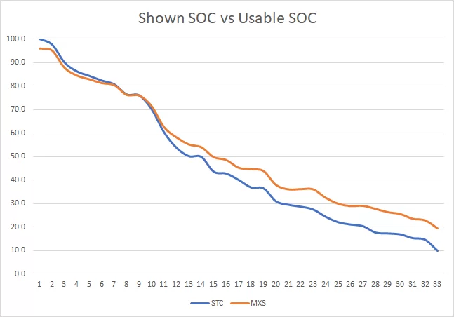

So the information in the first post relates to HV Battery Cell Max State of Charge (%).
The graph above is an interpolation of the data because I only I had a few data points. I have since gathered more data points and here is the graph of the raw data:

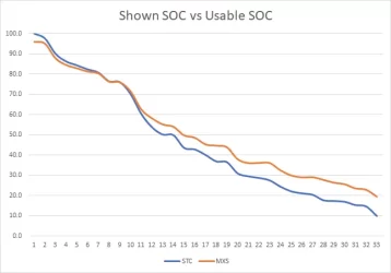

View attachment 1624[/QUOTE]
So the blue line is what it shows via the HL app that the SOC is but the orange line is what the actual SOC is. Looks like I'll be changing my stop times to end no more than 94% per HL app SOC.
So the blue line is what it shows via the HL app that the SOC is but the orange line is what the actual SOC is. Looks like I'll be changing my stop times to end no more than 94% per HL app SOC.[/QUOTE]
Correct, the blue line is the HondaLink State of Charge %.
X axis is just numbering the data points?
So based on the Scangauge II data, the ACTUAL remainder (battery capacity unavailable for EV use) on the low end is ~20% and high end is ~4%? At 20% (HL App 11%) it will switch to HV mode and may continue to pull battery level down below that if doing hills (I've seen it drop as low as HL App 8%).
Yes, you are correct on all points.
