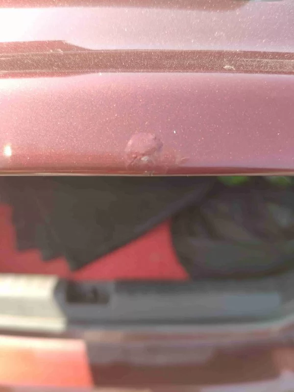

I'm curious also. Got any pics?
Thanks guys - this is a great forum..... Yes - it is aluminum! (I knew the car was a lot of aluminum; but hadn't considered it here)
bubble attahched :-)

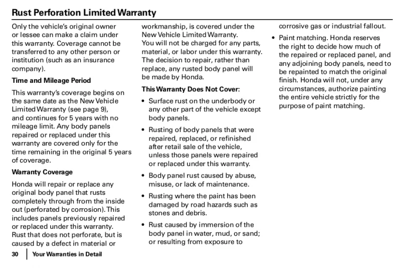

Isn’t the Honda Rust/Corrosion Warranty for a period of 5 years and unlimited mileage?
Yes Landshark, but the operative word is 'perforation' and I am pretty sure it won't perforate in the next 2 years!
Trying to find info on how to fix it has proven to be very difficult - "easy" (not) on steel; and I did ok on plastic;
but can't find a definitive explanation for aluminum. As I am not going to sell the car; I won't mind if I don't 'match'
perfectly; but trying to find out what to prep the clean aluminum with before doing the rest has been a chore.
My dealer was actually very helpful - but bodywork is not their business.
This kind of sucks -- Only covers "Rust Perforation" -->
But, I would argue that this bubble is NOT 'Rust" damage at all. It seems to me that it is a manufacturing paint defect.
Of course even that may not apply beyond 3Y /36K miles.
Of course. It’s always the bare minimum, even though there is obviously a defect in workmanship or manufacturing. It wouldn’t happen on a properly prepped and painted vehicle.
And, it has to perforate from the inside out. So, if you touched it with your finger, out of curiosity, and burst the bubble, you’d be SOL.

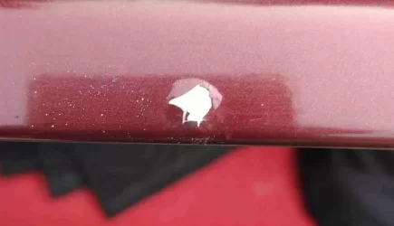

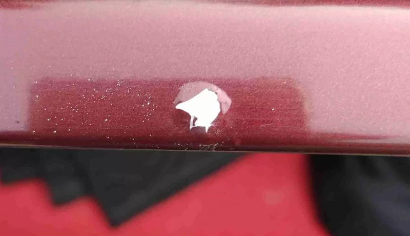

Thanks for the info - I used my dremel with a clean sand drum.. there was white aluminum oxide underneath.. sanded it clear;
degreased, and acetone, and coated it as a temporary fix, it is small enough and hidden enough (bottom lip of trunk lid) that I should be able to get away with a spot fix - wont' be perfect but will stop anything more for whatever time it lasts. I have touch up and spray.. essentially doing what the 3M site suggests. I was surprised as to how deep the corrosion had go will have to use a little glaze on it. Attached photo of the oxide - it extends a little onto the lip and is fairly deep.
