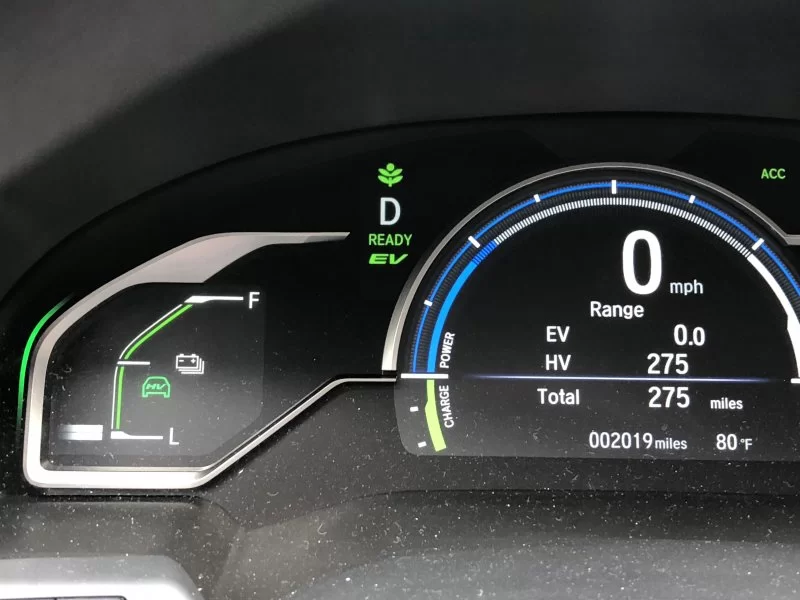

Had no choice today but to turn HV on the highway and about 6 miles left.
But EV range and bars kept going down until it reached zero.
The thing was that the last mile (off the highway) kept switching between EV and HV.
I thought HV mode was supposed to maintain the battery but somehow the car kept on using it?
I added 14.89 kWh for a full charge..
Sounds about right. HV mode makes some attempt to keep a charge, but it keeps some EV range available and switches to EV whenever possible. If you watch it while you are driving, the blue bar slowly shrinks. Engine comes on for a while, charges the battery a bit and then back to EV. It will do this even if the battery near full when in HV. It seems to make an attempt to put in roughly what it takes out but often times is not enough. This is likely also what leads to the angry bees sound as the car pulls the battery to the hard cut off.
As @Zor said, this sounds like normal behavior. I bet when the EV went to 0, you still had 2 bars showing on the battery gauge. And as it tries to maintain your SOC (and it’s related EV range) it’s not perfect. I lose some EV range on a long HV trip; usually around 5 to 7 miles and kW or two by the end of the trip. Try it again with a little more charge and I’ll bet it will hold the SOC and EV range better.
HV hold seems to drop to zero if you are close to zero, I have noticed that too. As Ken says, engage a little earlier, like 15 miles, or use HV Charge for a little to replenish some if you really want EV miles for later.
