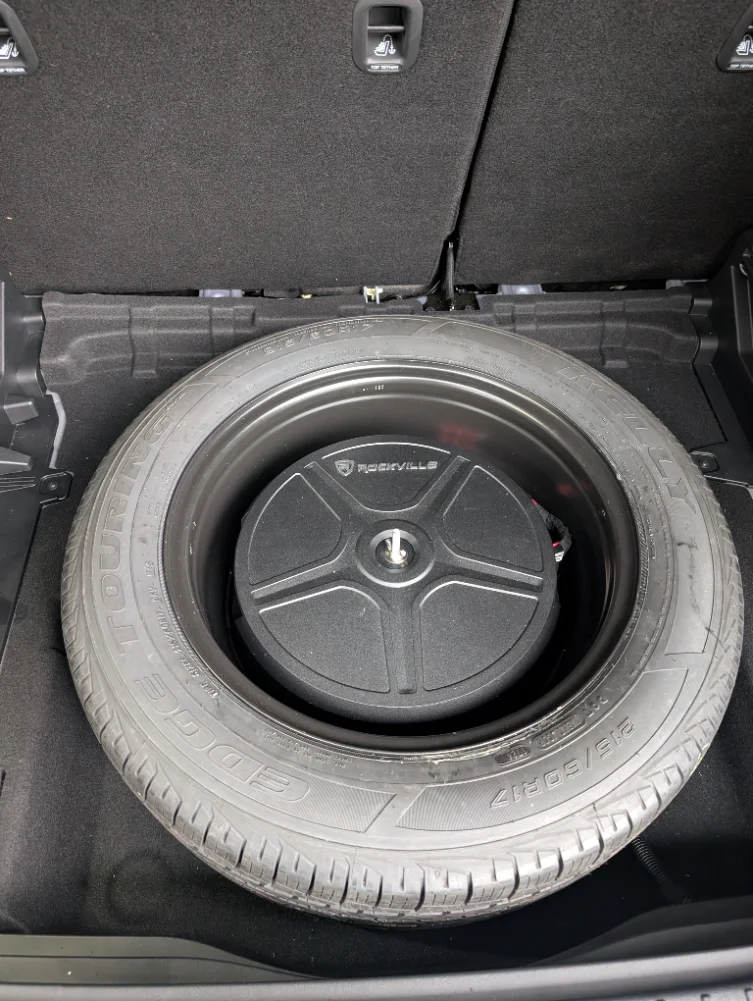

Recently picked up a full size spare, and now it is making this thundering vibration even with the 8mm rod c/w wingnut holding it down.

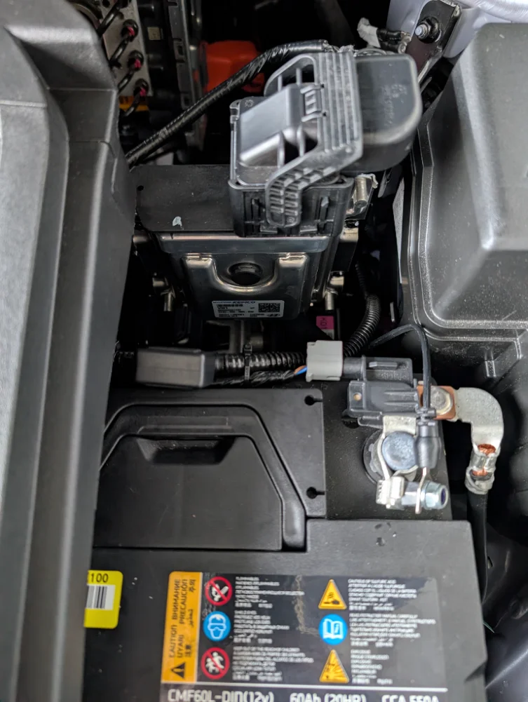

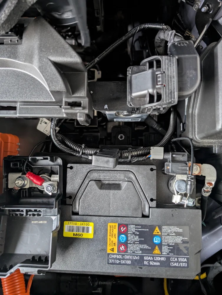

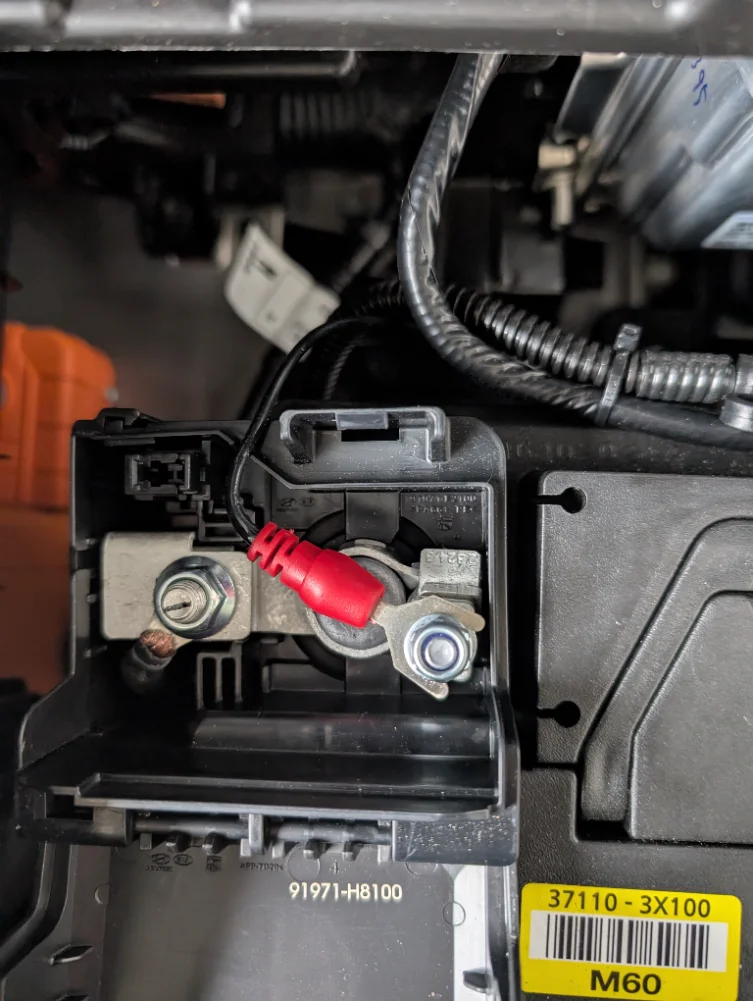

Here are some shots of the installation: Auxiliary battery wiring: Loomed Wire under left bolt positive side comes out from under utilizing the existing bolt
40A fuse in a weatherproof enclosure accessible with frunk cover in place:

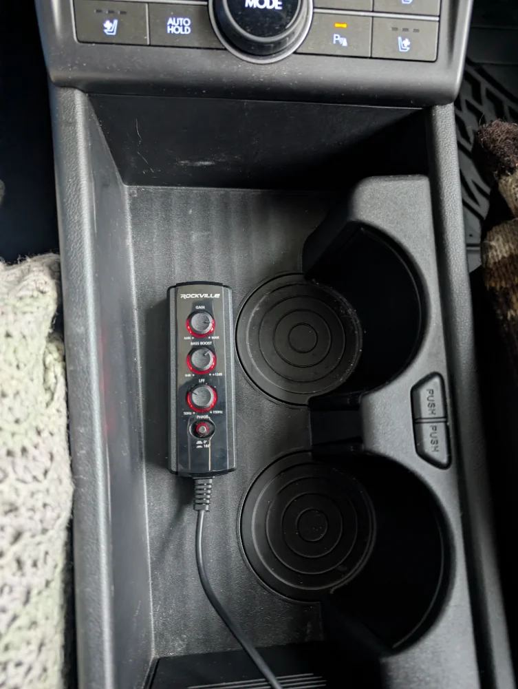

Remote control for fine tunning will live in center console (hidden), but also available to see the red backlighting indicating power on or off when car is on (Run mode or Utility mode):

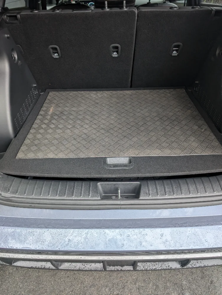

The cover in the back sticks up about 3/4 inch because of the full size spare. I will make a new black cover in the summer, recessing the spare into a hole flush for a more aesthetic appearance:
