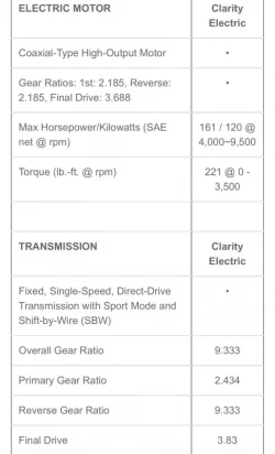

I maybe starting a technical arguement, but does anyone know the RPM specs for the electric motor? For example, what RPM is it running at 65mph? What is the electric motors max RPM?
I use the electric mode to climb hills on the freeway, but it is concerning if I’m high revving the electric motor under a load on a regular basis.
I found this about the electric model, but the rated HP rpm may not be the redline.

Not being flip, but just not sure what you are concerned about. As I understand it: There’s no variable mechanical gearing, so motor rpm is always going to be proportional to wheel rpm (and car speed). “Max rpm” of the motor therefore occurs at max speed of the car. (Though could be rated higher).
What about load? Going up hills means more load than on the flat. But (putting aside rare condition where engine drives wheels directly via the clutch, that you can’t select or control): if the load requires more power than the battery can supply, the engine kicks on and generates additional current to supplement the battery’s current. Regardless, the motor still drives the wheels snd so all the load is experienced by the motor*. This is true no matter what “mode” you are in.
HV, EV etc mode don’t change this and the electric motor can’t tell what mode you are in. The mode just changes how current flows between the battery, motor, and engine/generator.

Electric motors can't over-rev. The motor in the Clarity has a max speed set by the frequency put out by the motor controller and physical design of motor, and that also limits the top speed of the car. It doesn't have valves or pistons that are physically limited by movements and inertia at high RPM. They are less efficient at certain RPMs which is why the car has different modes of operation.

I think there is a misunderstanding to my concern. If the motor is spinning at 6,000 rpm @ 65mph because it is direct drive transmission that would lead to wear above a traditional CVT which would hold the RPM’s down. Honda is tracking our driving for a reason, the modes allow us to be test subjects. I’m just making sure I get the maximum life from my vehicle. I drive 36k miles a year and plan on putting on 150k miles. I’m technically inclined, but finding detailed info on this car difficult so far.

Electric motor RPM is no concern. Electric motors can run at high RPM all day. Heat is the larger concern to them.
I will see if I can get a specific gas engine RPM when the clutch is engaged at a couple different speeds. Electric motor RPM will be max at 100 mph, so no worries from it at lower speeds. Again, the transmission is designed to be operated anywhere under 100 mph, the top speed limit is to prevent issues like you suggest.

The car will reach 100 mph with gusto. That limit is the protection needed for the motors/engine. My guess is it has plenty of margin built in. If ratios are correct the gas engine would only be at 3500 RPM if mechanically driving the wheels. Traction motor is likely at RPM limit here.
Experimentally verified, torque pro on Android. Rough measurements from gas engine. With gear icon locked (clutch engaged, engine driving wheels mechanically)
2200 RPM at 60 mph
2900 RPM at 80 mph
This gives a drive ratio of about 2.85 if tires are 766 revs per mile. Assuming that the specified drive ratio of 2.75 is correct (3.42 * 0.805), the discrepancy is probably tire wear and deflection and measurement error. Measurements were only 4% off or so, to me this is confirming the spec correct.
Traction motor RPM isn't reported without knowing OBDII PIDs, but if RPM max is at 100 mph, at 80 mph you are at 80% RPM max. No issue.
