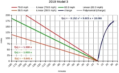

A recent 2,245 mile trip inspired benchmarking and generating this graph:
  • Drive segments lines at 40, 60, and 80 mph intersect at zero with the charge curve.
    • Limited to 3 hours (180 minutes) of driving
    • Maximum 30 minutes of charging in 10, 20, and 30 minutes
A horizontal line from one of the three speed lines to the charge curve gives the total minutes for one driving segment, the sum of driving time and charging time. For example, driving at 80 mph for an hour:
  • -60 minutes to drive 80 mph
  • +8 minutes to charge for that distance at that speed
  • 60 + 8 = 68 minutes for that segment
  • 80 mi * (60 / 68) = 70.6 mph equivalent speed combined driving and charging

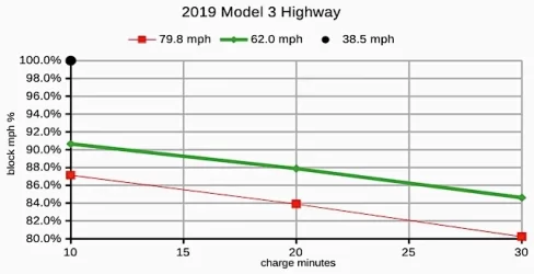

Driving at 80 mph for an hour with required charging, the block-to-block speed will at best be 70 mph or 70 / 80 = 87.5% of the EV driving speed. This leads to a more useful summary chart.
Here is a chart of block-to-block, speed efficiency:
  • 80 mph has the worst block-to-block speed efficiency, 80-87%.
  • 60 mph is better, 84.5-90.5%.
  • 40 mph is best, 100% within the 3 hour limit.

Let me explain this chart:
charge_speed-j_example-jpg.59046
  • At ~80 mph, my Model 3 drives for about 75 minutes before needing a 10 minute charge
    • 80 mph * (75/60) = 100 miles
    • 100 miles / ((75+10)/60) = 70.6 mph
  • At ~80 mph, my Model 3 drives for about 110 minutes before needing a 20 minute charge
    • 80 mph * (110/60) = 147 miles
    • 147 / ((110+20)/60) = 68 mph
  • At ~80 mph, my Model 3 drives for about 130 minutes before needing a 30 minute charge
    • 80. mph * (130/60) = 173 miles
    • 173 / ((130+30)/60) = 65 mph
There are similar lines for ~60 mph and ~40 mph. What happens is the rate of charge decreases as the duration increases. So the fastest block-to-block speed maximizes the rate of charge by using shorter charge sessions. However, this reduces the time and miles traveled by that charge.

Bob, this is really excellent data. And very interesting outcomes. I would love to see others with other models do a similar experiment to rule out differences between cars/tech.
What are you using to collect it?
Primarily, the car metrics with at least 10 miles to even out the data. I also have Tessie but it is more for trip logs.
To me the missing piece is the different charge curves (when in miles) for different speeds. That is, you won't get the same number of '80 mph miles' as '60 mph miles' in an equal-length charging session.
I believe Tesla makes this hard to see as they report EPA miles regardless. But some additional math could convert everything to kWh to get the total drive+charge time to cover a certain distance at a certain driving speed.
Some refinements would include a time and mileage penalty for each stop (assuming they're not highway rest areas), and also your initial period will be from a full charge rather than what you fast charge to, so the first couple stops will probably be for comfort rather than optimal speed.
(I once did a back-of-envelope calculation that showed you should drive around 1/2 of your charging speed (in actual miles at driving speed, not nominal). So if the charger is giving you more than 150 mph of actual distance, drive as fast as you're comfortable, but in other situations (slow charger or high drag, like towing) you can save more time by driving slower and not waiting as long to replace energy.)
Interesting and consistent with my experience. I have done many long distance trips in my EVs over about 5 years. I have owned 5 different EV's and have learned to look at the drag coefficient of any car before I buy it if I plan to use it on the highway. Also charge curves are available for most EVs and knowing what it looks like for my cars helps me find the sweet spot. Don't forget to add some time to deviate to the charger and plug in etc, that can tip things a little toward a little longer charge.
