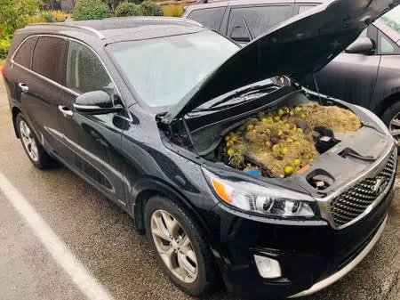

Just saw this...
Squirrels took up residence in this vehicle (in Pennsylvania) and were storing walnuts there.
82c5f035825e5b82bb9ac1cf2057a0c6
The owners noticed a burning smell and a strange noise !!
