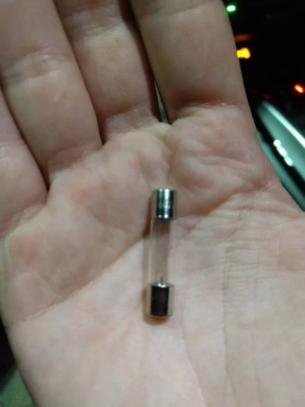

I just popped my cover open a d found this style bulb. I want to replace it with led, but i'm not sure what it is.

I just popped my cover open a d found this style bulb. I want to replace it with led, but i'm not sure what it is. I just popped my cover open a d found this style bulb. I want to replace it with led, but i'm not sure what it is.

I just popped my cover open a d found this style bulb. I want to replace it with led, but i'm not sure what it is. I just popped my cover open a d found this style bulb. I want to replace it with led, but i'm not sure what it is. I just popped my cover open a d found this style bulb. I want to replace it with led, but i'm not sure what it is. View attachment 533
That looks like a fuse (if your post wasn’t tongue in cheek). ;)
The color temperature of the SuperbrightLEDs is 6500K. This is like sunlight (very blue), so if you want warm white, these won't do. That said, I've ordered them, too, hoping that it won't be too noticeable. We'll see...
Just received and installed the SuperBright LEDs I posted about. They were the exact size of the OEM filament “fuse” size lights. Went in perfect and took all of 5 min. They are much brighter than the OEMs and I do not find them bluish at all. I’d call them cool white. They are just slightly whiter than our convenience lights which I thought were white but look slightly warmer than these.

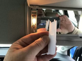

Also my original instructions on removal and reinstalling were incorrect. Removal is as stated from prying on cut out on outside top edge but you reinstall by putting the tabs on the top of the cover in first and then you snap in the bottom.

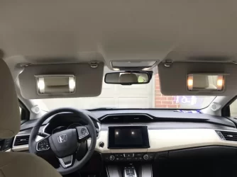

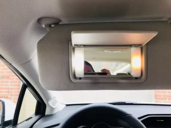

Here are some before and after pix. My apologies for the over exposure and blooming of the light intensity. In real life the OEMs are dim and the LEDs bright. But the colors are representative of how they actually appear. Also included a pix of the opaque cover so you wil know what you’re prying against. I went slow with a dental pik and didn’t break any tabs off.
Bottom line-I don’t think they are blue, just cool white, and so I don’t think the Missus will make you sleep on the sofa if you install these. I’m very happy w them.

Thanks. I presume your picture is showing the led’s on the driver’s side and the original bulbs on the passenger side.
