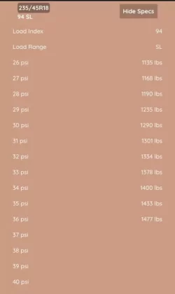

Here’s a load and inflation chart for a 235/45/18 tire with a Load Index of 94. Pick a brand, any brand, the specs will be the same. Industry standards. Note that the maximum load rating of 1477 lbs is achieved at 36psi, even though the maximum cold pressure on the sidewall is 44psi. The maximum load on 4 tires, assuming perfect weight distribution, is 5908 lbs. Any 235/45/18 94 will meet OEM specs. Don’t overthink it.
