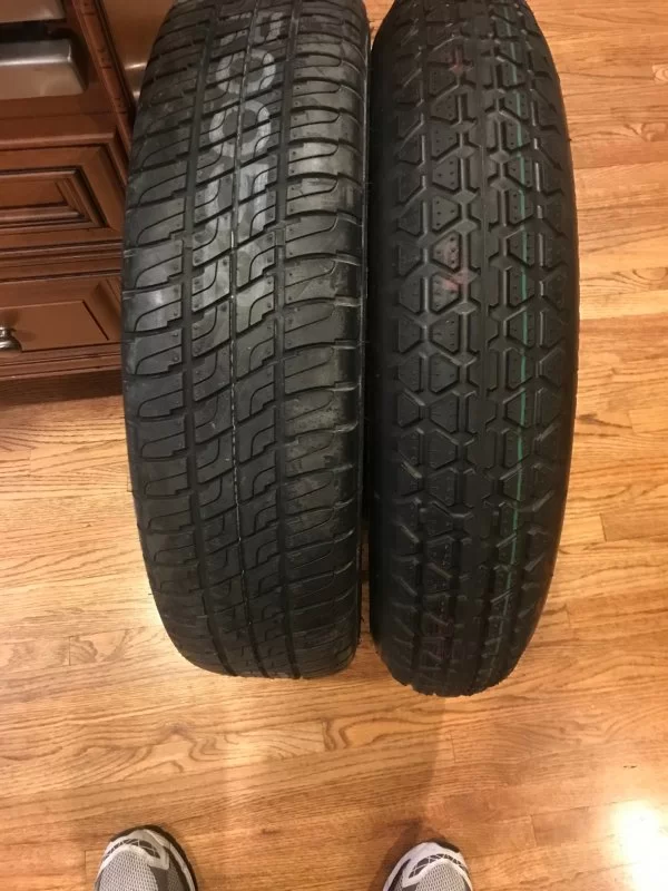

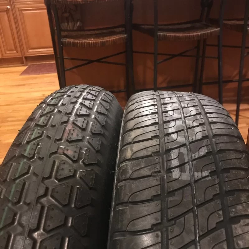

Just thought I would update this thread. I really like the replacement tire on the aluminum Infiniti 17" wheel. Here are a couple of pics of the new spare with my spare. I was able to change it out for about $75 total including mounting charges. Unfortunately, I had to buy the Ford Escape wheel in the auction link from my earlier post as the reseller I hoped to use fell through.
