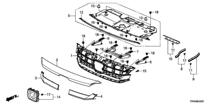

wanted to see if anyone had the specs / instructions for replacing the front grille assembly. Babysitter bumped into a car in front of her and it looks like just the front grille is cracked and emblem fell out. No airbags deployed, no codes being thrown, radar seems to work fine, lights and everything else seem good. Was thinking I’d at least take it apart and see what’s going on. Would rather replace the grille myself for 130 bucks vs body shop / dealer for hundreds more. Money is tight during these Covid times.
here’s a pic of the part diagram from Honda parts now site. I go there frequently to see the blow up of certain parts assemblies. Helps a ton.

Should be pretty straightforward, after removing any cowls (typically held on by push clips), Honda grilles typically have two retaining arms going from the grille to the front core support, then remove the front bumper cover and you should have access to the bottom side of the grille to replace it out. The bumper cover will probably have a few screws you can access through the wheel wells and a bunch of push clips underneath. Once those are out, just peel the cover off, disconnecting the fog lights as you do so. The grille itself probably has wiring too.
