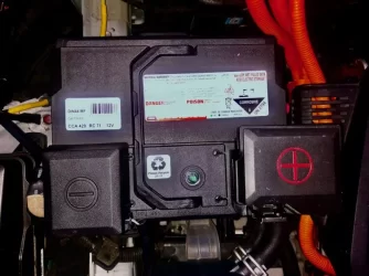

After my Kona EV "died" I started reading threads here about problems with the aux 12v battery. I jumped it and will take it to the shop tomorrow to do a load test and see if the battery needs replacing.
So I'd like to know in advance - can any standard car battery be installed? The one that came with the Kona is a smaller shape than I normally see, so I don't know if that's an issue.
