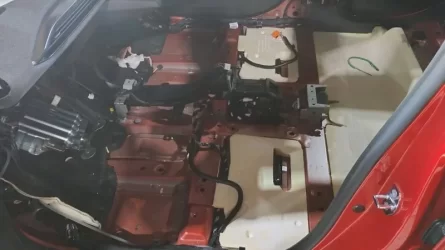

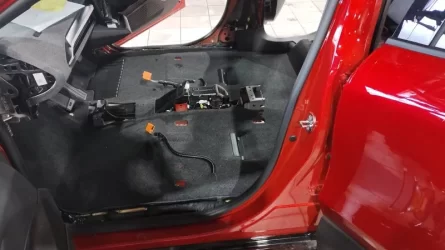

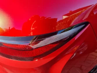

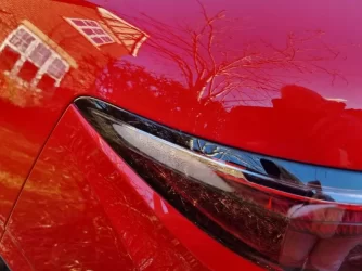

During November and into December I became aware of a foul stench within the cabin that got worse and worse. I was unable to locate the source until 18 December I discovered that the carpet under the mats in the passenger footwell was wet. Further investigation, pulling back the carpets, revealed soaking foam and standing water in both front footwells and even in the low point of the rear passenger foot area. Took car to the dealer the same day and they eliminated usual suspect cause (windscreen wiper drainage). Car booked in on 8 January 2024 to investigate and carry out (hopefully) the Renault agreed bulletin solutions for this problem. The car was stored under cover between 18 December and drop off on 8 January. During this time I recovered approximately 1 litre of foul smelling brown water out of the floor area with a Vax machine. At drop-off I also reported significant condensation present in the complete rear light arrays on both sides of the car.
I collected the car on 23 January and was told that the wheel arches had been sealed using specialist sealant, the front foam and the entire carpet replaced. Rear lights were on back order. I was surprised that they hadn’t removed both wings as EV forum members with identical problem claim that this is essential and is the fix required by Renault. On 23 January I washed the car with a standard hose and checked the passenger footwell after easing back the carpet. Once again it has become saturated. The car had not been driven or left in the wet since pick-up so the water ingress must be from my wash or from a wash and/or testing at the garage.
