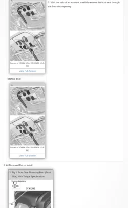

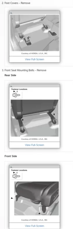

You didn't say if you have the manual seats or the more complicated and heavier electric seats of the Touring trim. Of course, both of them are armed with explosive airbags, so you'll want to disconnect the battery first.
Here's a junkyard video showing how to remove generic Honda seats
How to Pull a Honda Front Seat

I've done it myself before, it's really easy. All seat bolts are to be torqued to 30 ft lbs, but you should be okay with "common sense" tightness
