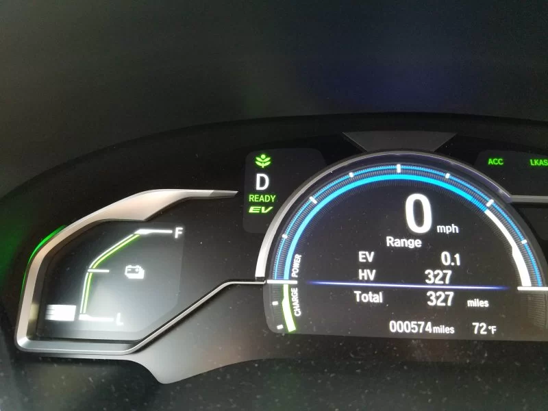

As I begin to learn more and more about the Clarity, the more I like the car. Recently, I ran the battery down as indicated by my EV range, but my remaining battery showed at 3 bars.
Go figure.... What is the correlation between remaining bars and EV range?

The car's battery management system, aka silent HAL, will prevent your battery from fully discharging to protect it so you'll always have a couple bars then it switches from EV to HV (ICE).
Most of us have found the lowest reading to be two bars. We are sure this is controlled by the car so the battery can not be fully discharged; a process that is known to damage Li Ion batteries. Funny Honda didn't do the same thing on the top end and the car can charge so the gauge shows full. But we are certain that a 100% shown on the display is not 100% battery charge for the same reason; Li Ion batteries life is shortened by full charges.
Pretty much all electric cars behave the same way.

I could be wrong, but I think there are two low end buffers. One at the bottom end is simply to keep the battery from fully discharging and thus extend the life of the battery. But I think there is a low-end operational buffer that allows the battery to enable some limited hybrid-vehicle behavior. Not for long climbs up hills, but enough to supplement the ICE and improve the efficiency. It is my belief that this HV buffer is the two-bar buffer that we see on the gauge. I believe the bottom-end battery protection buffer is unseen, like the top end protection buffer.

@V8Power , I did a limited real world test by allowing my EV to go to 0 and 2 bars until it auto entered HV (it was hard to do as I suffer from IAS [ICE Anxiety Syndrome]).
In 20 miles of mixed city and highway driving with speeds of 35 and 55 and no large hills, everything was fine. The 2 bars never increased and I had no loss of power or high reving although I suspect that on a large enough hill I would have. I could not force myself to test longer, but I suspect that you get a little lower MPG since this limits the full range of power flows the algorithm can select from. This observation might support @Ray B ‘s theory that even at the 2 bar buffer limit, the algorithm allows a small amount of back and forth charge/discharge but not as much as in a normal/larger SOC and thus you get the angry bees when calling for more than just limited amounts of power for short durations.
As to the buffer question. We have several observations that with a fully depleted battery (0 EV, 2 bars) only 14.1 to 14.4 kW could be added to the state of charge (SOC). So 14.4/ 7kW = 83 to 85% of the battery is allowed to be usable. So we assume that 15 to 17% is the total buffer but we don’t know how it’s apportioned between top and bottom. But one also has to take into consideration that the charging inverter in the car cannot be 100% efficient and so not all of that 14.1 to 14.4 kW actually makes it to the battery pack. You can’t beat the laws of thermodynamics and so some of the kWs measured at the wall by your EVSE or Killa-Watt meter are lost to inefficiency as heat in the car’s charging inverter. I’ve seen estimates of inefficiency anywhere from 20 to 5% and speculation that Level 2 charges may be more efficient than Level 1. If you assume a around a 90% efficiency, then only 12.5 to 13 kW are allowed to be used. Then that’s a total buffer of 23.5 to 26.5. Holding about 25% of the battery capacity in reserve for battery protection and to mask the unavoidable degradation from the consumer is roughly on par with other EVs and is another indication that our assumptions and speculations are at least in the ball park. Again, what we don’t know is how this assumed, appropriately 25% buffer is split between the top and bottom of the SOC.
Also common sense informs us there must be buffers at top and bottoms since every other large Li-ion battery pack has this and the chemistry/physics dictates that repeated full 100% charge and 100% discharge cycles will destroy any current Li-ion battery no matter what the chemistry or configuration.

Here's a short version of what Ken wrote: the rated sizes the battery is 17 kWh. When the car has 0 EV range and you plug it in to charge, the car will only actually take about 13 kWh. So there's 4 KWh that can be used as a buffer. They are designed to not use up the whole capacity of the battery to have less battery degradation.

I think the reason is to show you that the car is now functioning as a hybrid. If it showed zero EV it would imply the car is running only on its tiny motor. Its a good thing that does not happen.

I believe that when you get to 0 charge/2 bars, you ARE running on engine power alone, not hybrid power.
