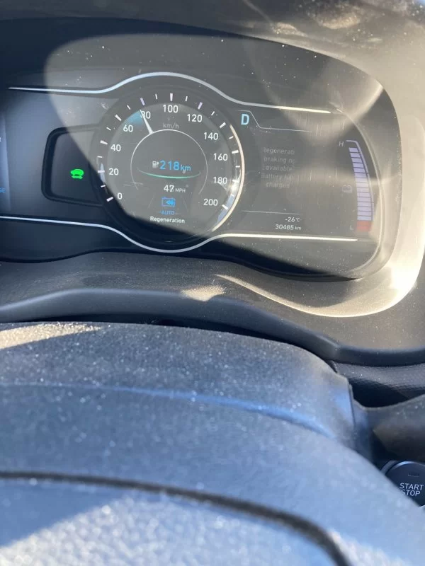

Recently I’ve been getting this warning message pop up while driving ‘Regenerative Braking unavailable Battery fully charged’. Even though the battery is obviously not fully charged due to use.
Has this occurred to anyone else? Any ideas? Is it due to being cold as balls outside?

It is possible one or more cells may have higher SOC than the warmer ones located closer to the center of the pack. Looking at your SOC gauge, it is close to the top, so the BMS may be protecting those cells from overcharge. Try driving a little while to reduce the overall SOC and see if the message clears.
I assume you have "winter mode" enabled.
It's likely the cold. Battery can't take the fast charge when it's frozen. I've seen it myself under similar circumstances.
I do have it enabled. However I hardly see any energy used under the battery care section. Even at these temperatures.
