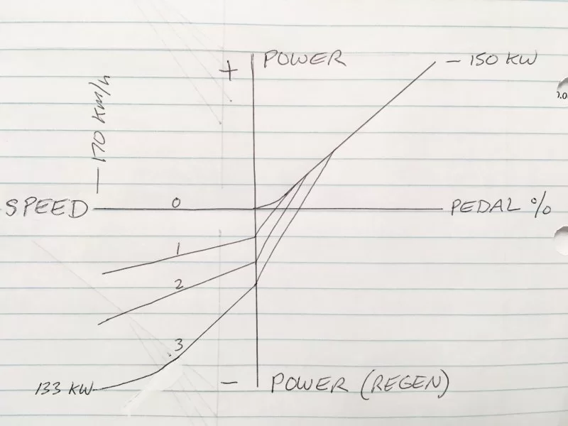

...I'm a bit confused that increasing the levels during acceleration decreases the acceleration only slightly but noticeably....
This question has come up several times in the past. Regen does effect accelerator pedal mapping and it's more noticeable as you approach lift-off. If it didn't, the onset of regen when you lifted off would be abrupt and there would be lots of complaints. You'll note that in Level 3 you can still achieve coasting at very low pedal pressure. The Level settings simply move the zero-torque demand (coasting) point further into the pedal range, roughly like this:
Thanks everyone for your responses. The remapping of the accelerator makes sense to me. I'm a bit annoyed that level 0 it not a option in the default settings. Atleast the padels makes adjusting it down easy, just annoying to have to do it everytime.
