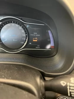

My wife just sent me a a picture of a warning message - "Refill inverter coolant", which popped up while she was driving. Can I top it off? Where is the reservoir located?

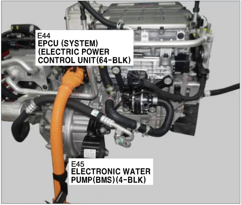

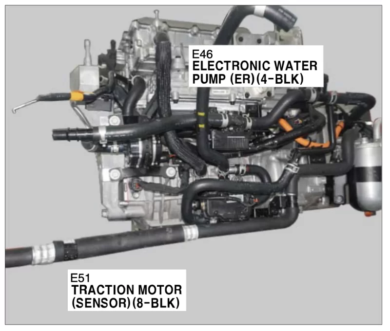

Maybe a pump issue or sensor? Picture of the one at the front:
This one is for the BMS at the rear (not the one for the inverter/ motor but might as well include it while on the subject)
Thanks to @KiwiME for the photos. Note these are coolant - not water pumps :)
