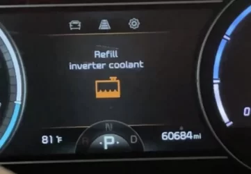

I wanted to post this in case anyone was having the same issue. For the last year, after having the coolant flushed, we’ve had a persistent warning light that doesn’t go away and can’t be cleared. Apparently other hybrid and PHEV Kia’s have the issue as well.
We contacted Kia a dozen times with no help, but another user here posted about a new recall issued SA512 Inverter Coolant Debris Warning that addresses the issue. (Note despite calling them monthly Kia never contacted us about this, we found out via this forum and asked for it at the dealer directly)
The dealer said they were waiting for a new machine that properly clears the alert and reflushes the system, and now that they have the new equipment they can perform the recall. As of now the alert is no longer displaying and I got the car back with the coolant centered between min and max. It’s the blue low conductive coolant. Ours is a 2020 Niro EV EX.
I can't edit the post anymore....the recall DID NOT WORK. After a few days the coolant dropped way low, they refilled it, it's been dropping a little more, but even with full coolant the light came on again.
RECALL DOES NOT WORK.
Back to the dealer...and now, even though I've been trying to get them to fix this car for a YEAR, now that I'm over 60k they say my warranty is done and they will no longer cover any service to the coolant issue. I have to pay in full now, which is exactly what I thought they'd do even though WHEN I WAS AT 40k I asked them what would happen once the warranty expired and they assured me since the issue was reported and ongoing with the warranty intact that I'd still be covered. This feels like a scam.
