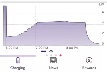

We use free public L2 chargers. We have not been able to look at amps during charging, but we have noticed that we get 3 or 4 kWh per hour of charging when it is cold instead of the normal 6 kWh. The charging returned to the normal 6 kWh with spring, summer temps.

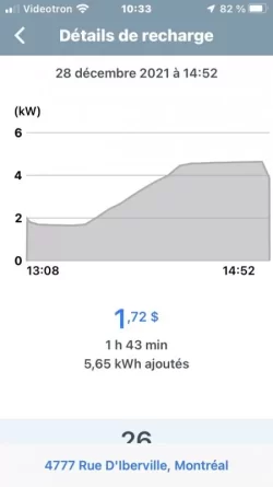

Today’s charging - a bit faster, but it seems trying to keep it at 4k
It is quite interesting that your graph seems to depict a 'normal' charge rate (~ 7kW) at first (for maybe 10 minutes) before dropping down and entering the odd profile.
It never gets anywhere near that cold here (thank goodness), but that could very well be the reason.
The plot sent by @Brigitte seems to look very similar to yours, which may offer you some comfort that this is 'normal' behavior given the conditions.

Here is my dealer's answer
Hello,
I took the time to review the information you sent me and as I noticed, your charging time is not enough to fully charge your electric battery.
In cold weather, before a battery can be recharged, it must first be heated by the charge you provide and it is only once the battery temperature reaches a temperature acceptable to the vehicle's computer that the vehicle begins to charge the electric battery.
A normal charge that would take 2.5 hours can take 220 volts in a hot temperature may take more than 6 hours to charge in cold temperatures or more.
The principle of the vehicle is like that of your cell: leave it plugged in and it will decide when the charge will be over.
If you remove the car from charging after 1 hour and 13 minutes, you probably didn't charge the battery at all, you just heated the battery to prepare it for charging.
I have included 2 pages of your owner's manual for you to consult.
So that you can believe what I am explaining to you, when the temperature warms up, you will see that the charging time changes, which will confirm what I am explaining to you.
Thank you and hope it will help you better understand how this new technology works
