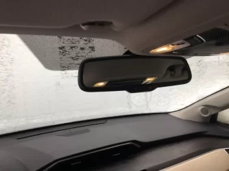

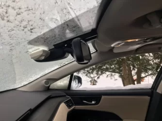

Just checked mine...it rotates so high it touches the windshield and points directly at the back of the dome light completely erasing the rear window by moving the mirror too high. See pics below. I’m 6’1”. Surely yours is capable of the same. There are 2 articulating ball joints on the back of all mirrors. Grab it wih both hands and pull it upwards toward the roof...make sure you’re using both ball joints and not just reaching the limits of one of the 2 ball joints.
As a tall person this is the first thing I do when I get into any car I willl be driving regularly...they are ALL mounted way to low for me, so I grab with 2 hands and while keeping it facing the back window I shove that mirror up toward the roof as high as possible, making sure both ball joints articulate, primarily to get it out of the center of the dang windshield because it hampers my FORWARD visibility. I assumed all tall drivers did the same lol...

Perfect. Thank you. I was trying with one hand, and did not want to force it. But, it moved easily with both hands.
