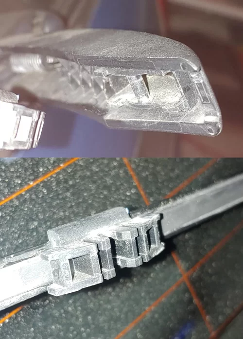

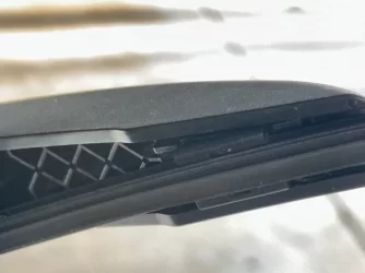

I've tried doing what you describe, but no amount of wiggling or pushing loosens the wiper. I'm very concerned with breaking something at this point. Here are a couple pictures if it helps to make sure we're taking about the same thing.

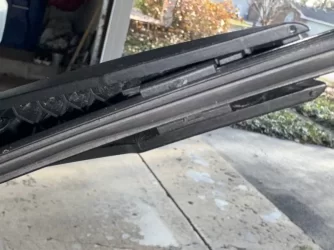

I'm just really bad at writing instructions. I've popped it out twice using my hands, and with a plastic removal tool as the second method. Tool is easier because you can pry off one side at a time. Pry where the square outlines (on wiper blade) are located for better leverage.
If you don't need the wiper blade you could just use a metal slot screwdriver to remove the wiper blade. The wiper is symmetrical and it snaps back in!
Got it, thanks! Just needed to see it removed to be confident I was doing the right thing.

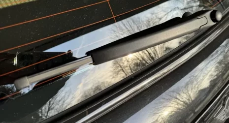

Well, hit another snag - the Bosch wiper that was supposed to work doesn't. The type of adapter on the original blade is completely different than everything I'm seeing online, too, including MINI's own website. Ugh...

Well, wish I had found this post earlier, it shows that the 2022/2023 models have different wiper arms. Probably explains why the manual makes no sense, it wasn't updated. Anyway, for reference in case anyone else finds themselves in a similar boat:

From the ECS Tuning post @LittleWoods linked on North American Motoring:
Yep they changed the design on the arm 22+ https://www.ecstuning.com/b-genuine-...r/61615a404f6/
Valeo usually has the aftermarket on Beam design which this is, being so new does not look to be out yet. I can message them to see since we have the direct relationship with most OEMs.
61617347623 is the pre 2021 : https://www.ecstuning.com/Search/Sit...h/61617347623/
