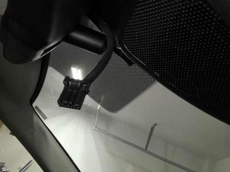

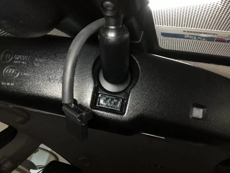

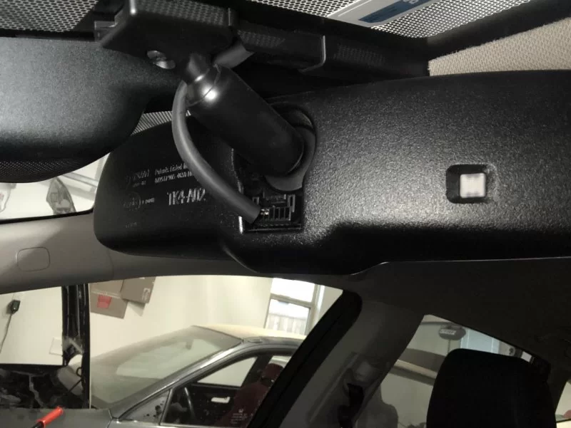

It will take 5 seconds to unplug the mirror as the plug is luckily on the back of the mirror not in the headliner. You will then need to tuck the wire up somewhere though.
Note that once you unplug it, you'll have no dimming (there is no manual dimming). I'd wager that this mirror is from the parts bin, so a manual mirror from, e.g., a Civic or older Accord, would fit the mount.
