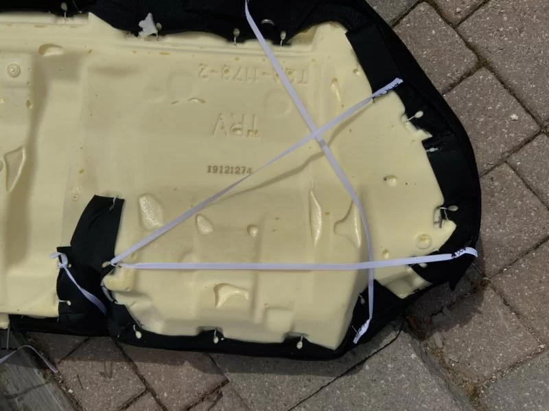

Problem solved
I removed horizontal part of the seat (instruction here )
Stitched some rubber string from underware to the tabs

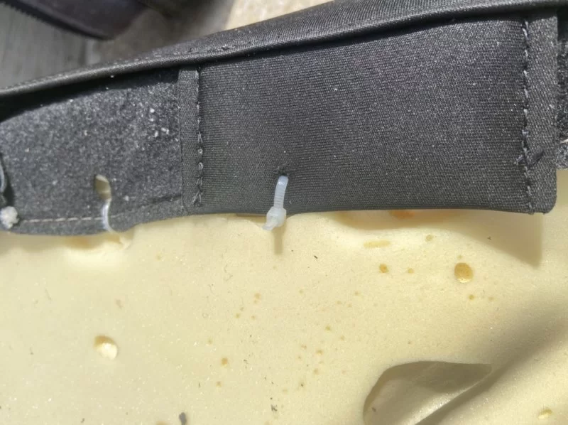

Later got a better idea and drilled tabs and used plastic tie wraps to connect them to metal bars inside the seat
Also had an issue with the small side vertical cover - lower tab always crawling out. Put a tennis ball under that part to hold the tab in place.
Seems to be good now, and looks way better

Video is not mine, but pictures are. Should have done all tabs using tie wraps, fast and easy fix.
