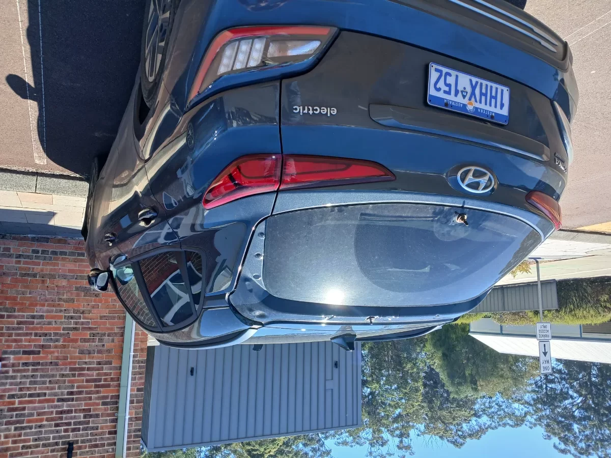

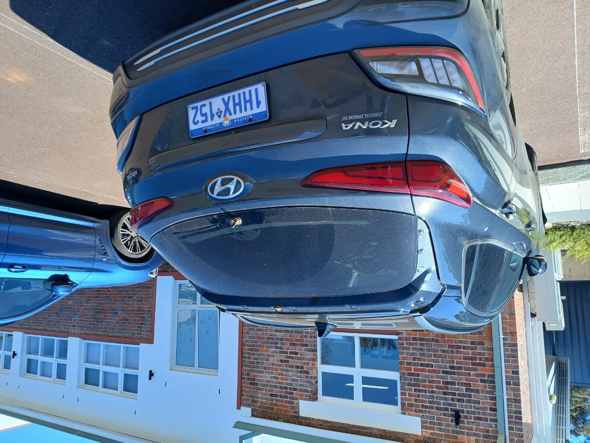

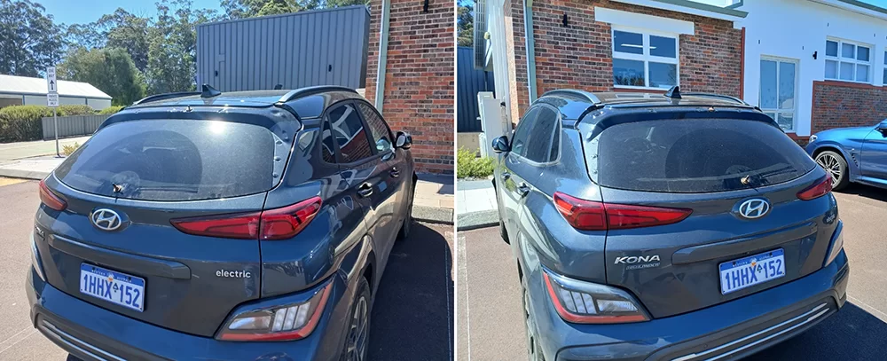

Hi has anyone had there rear eyebrow over the rear screen remove, because it looks like it causes more drag and less MPG,s, its 5 10 mm nuts and the high stoplight and rear wiper water wash tube to disconnect to do this, i.e. MG4 without this has more range than the MG4 with this and looking up on UT shows' video's of SUV,s having lower drag without the rear eyebrow , I have a 2022 smooth Kona electric and i have already fitter the front wheel arch flaps from a EV6, this seems to work well as there is a lot less water leaving the side of the front wheel wells, its pushed down on to the road instead, your thoughts please thank, as shown here

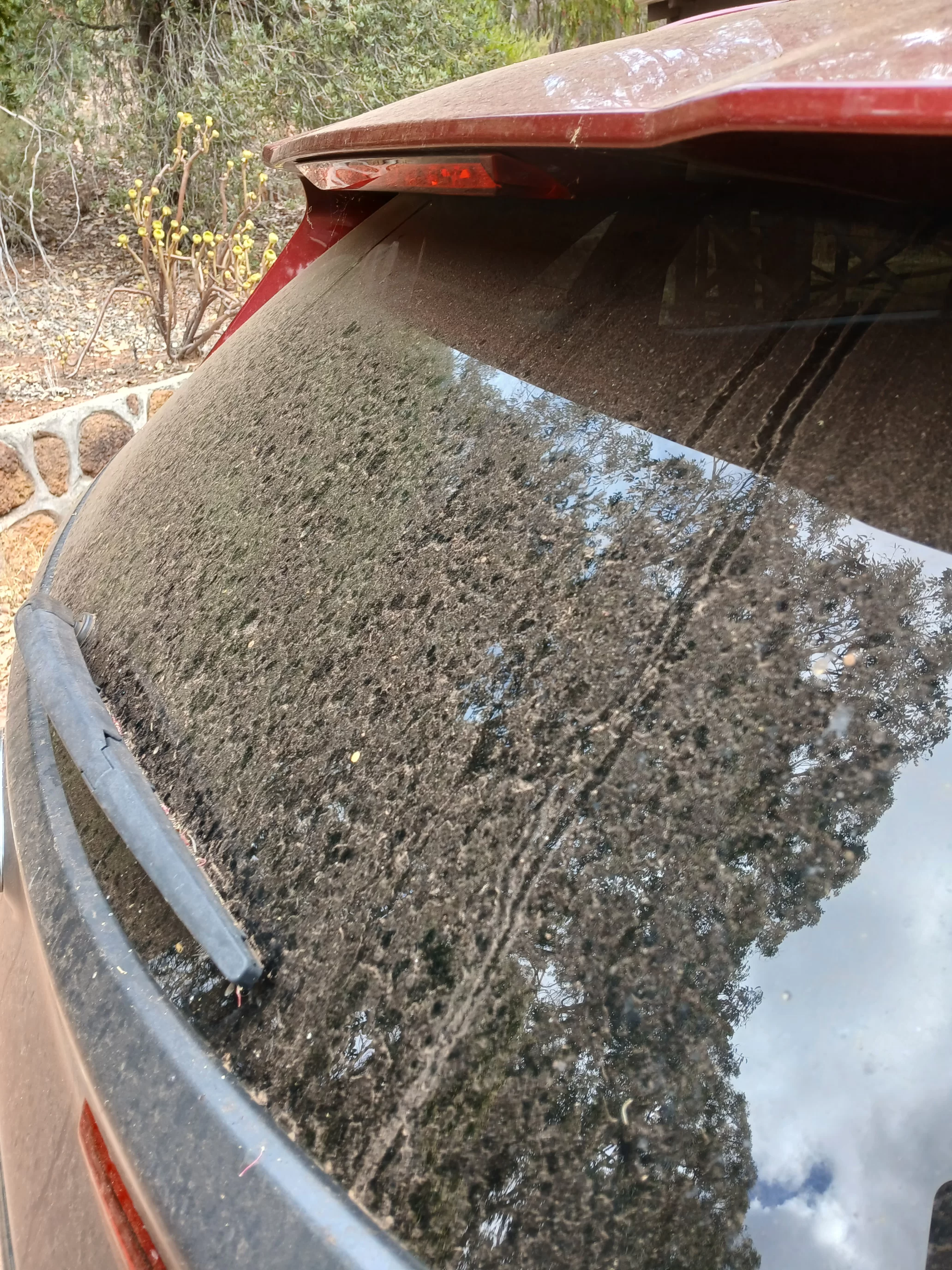

Rear spoilers do just that, 'spoil' the airflow after it passes over the roof so that it breaks free at a consistent location. For the lowest drag, ideally the airflow would remain laminar all the way to the end, as it would if the car had a natural teardrop shape. But the abrupt end of a conventional car shape makes that impossible. If the flow is going to break away at some point and change to turbulent flow anyway, it's far better that it's done at a consistent edge to avoid flapping noises as the flow flutters between modes at rapidly-varying locations near the top of the glass.
So removing it is unlikely to lower drag, rather add noise but reduce the accumulation of dust on the rear glass.

question then if i may, the ev6 all models of Tesla,s Do not have one and they are in the lowest drag range averable of cars to drive on the road
@No Ice, the Kona's basic shape is 'boxy', as contrasted with purposely-designed aerodynamic vehicles. i'm astounded by the improvements Hyundai made to this box when they adapted it to an EV - note how little retardation there is at 70 mph when you kick it into zero-regen, compared with most other vehicles when you shift them into 'neutral' at speed. I believe there is a formal aerodynamics and rolling resistance test to see how far a vehicle can roll before it stops,
The spoiler was first introduced in a 'boxy' station wagon by aircraft manufacturer SAAB in the late 50's/early 60's. It had a slot for managing the airflow which had the added benefit of keeping the rear window less dirty. On the Kona it has the added benefit of keeping nighttime dew off the window.
