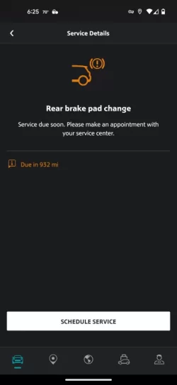

Just got a "rear brake pad change" warning on my 2022 with 5,200 miles. We drive mostly using regen and very moderate ACC use. Regardless, seems way too early for something like this.
First actual service (two years) is due in 9/23.
Anyone else getting this message?

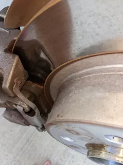

Are you able / willing to remove the rear passenger side wheel to verify if the pad is indeed worn down? Look in the back of the caliper. The sensor is at the end of the wire. It's a real warning of worn pad if the sensor is touching the brake disc. You can see in this picture that the sensor is far away from the disc.

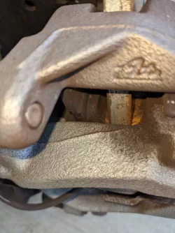

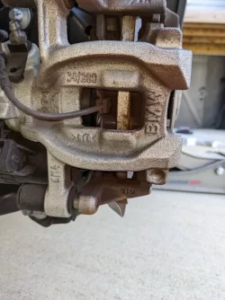

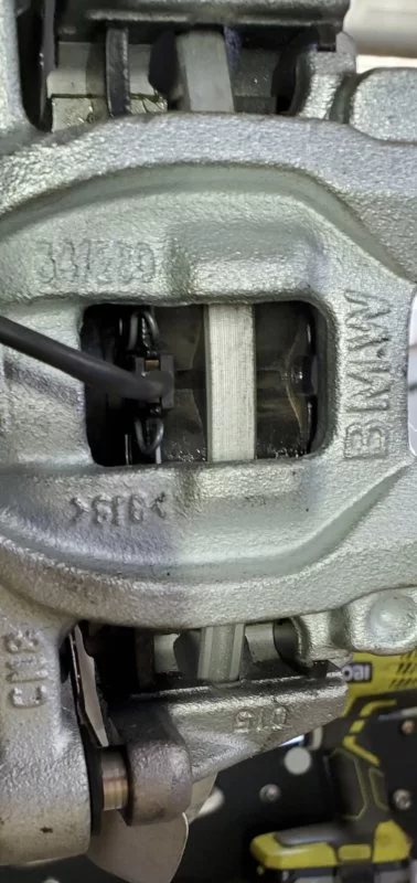

Pulled the right rear wheel off and the pads seem good to me. Sensor seems far enough away from the disk, although I'm not an expert.
Seems like a broken sensor. I'll schedule a service appointment and see how that goes.

Following up. Scheduled service and they replaced the brake sensor. Easy enough.
