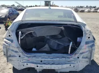

We just bought our second auction clarity and although all of the parts are included I was looking for some kind of video or content to instruct us on how to install the rear hood, trim and bumper cover.
Any help would be greatly appreciated.

Well, first of all, your rear bumper beam is missing, I would get that installed before putting the bumper cover on. The bumper cover goes on pretty easily, it snapps into its respective clips, and there are screws at each wheel well and 2 bolts on either side of the area the trunk covers when closed. Interior trim pieces are pretty easy to install, try messing with the pieces until they line up, then use some clips to secure them in place. I can get you the details from the service manual if you want.
There is a writing harness on the driver's side you need to connect for bumper sensors and the beeper thing, make sure it's connected before popping the rear bumper into place.
