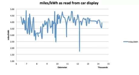

At 54F I don't use the heat, just the seat heaters if necessary. Thus my range is at least 4 mi/kWh under those conditions. The range shown as the middle number in the dash does not mean much, as there are too many short term variables affecting it. The best calculation uses the miles traveled and the kWh used. I note this down before fully charging either in hilltop reserve or fully topped off, and so I have data that show the variation I see with odometer miles, and mostly journey by journey, see below......one of the InsideEVs guys shared his results.

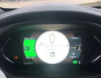

With the temperature around 54 F, and the heat set to 68, the car says he can get 202 miles. Half of his commute is highway at about 70 mph, the rest city is streets at 40-45 mph.

There is lots of discussion on this topic on many Bolt EV related BBS. The use of the heater in winter is the biggest hit on the range. There may be a hit on the battery, but I have not been able to prove that to myself yet, as clearly as I see the effect of the heater when I switch it off for a whole journey. Right now, with use of the heater, I have about 190 miles range as readout on the dash. In summer, using the A/C I easily have ranges between 220 and 250 miles. With Hilltop reserve, my range in winter goes down to about 155 miles, while in summer it goes down to about 200 miles. You have to bear in mind that extreme cold around 0F does appear to affect the battery significantly, but I have not experienced these temperatures for long enough to really come to a conclusion. Also, there is a large day-to-day variability in these numbers that depend on just about anything to do with driving around up and down hills, speed, and other driving details, that you cannot base your conclusions even on a few days of driving. If you scroll up a bit in this discussion, you will find a graph of mine that illustrates the magnitude of the variability.Surprised to see no discussion of how far people are actually getting in the Bolt. I just got mine, but does not look like anywhere near 238 miles so far.
