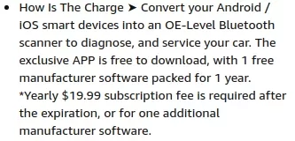

I looked at the Autel AP200M - about $90 Can from Amazon....BUT - do you 'have' to pay $19 a year after the first year; or will it not work if you don't pay?
I would only get it for the Clarity battery info; but wouldn't want to perpetually pay $20 a year to use it..

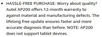

With the original AP200 (which I have), this is the relevant statement in the sales information:
You could be correct however. Here is a statement (Amazon seller) for the AP200M:
The Amazon features list does not seem especially authoritative, and I have seen errors in the listings with regard to the C/H/M.
More research is required. Maybe this is the reason they are getting rid of the original and going with this confusing array of new ones - to increase their revenue with required annual payments.
It is also quite possible that the annual payments only apply to obtaining updates. It is hard to believe they would disable your existing functionality after a year if you don't pay a fee.
The AP200's are still readily available. Perhaps that's the best choice until they are gone? I'll try to find some more authoritative information (maybe something on the Autel pages).
